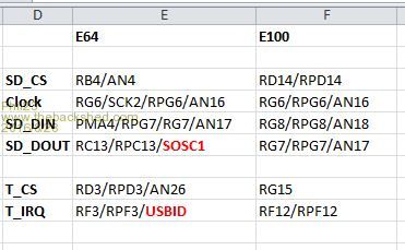

I don't really understand what goes on inside these chips.
Only that there's different capabilities on each pin & that they seem to be in groups internally; the RA, RB, RC designations etc.
Thing I noticed between the E64 & E100 is the capabilities on some of the pins used is different.
I won't even pretend to know what SOSC1 & USBID mean; just an observation that other might see as relevant or not.

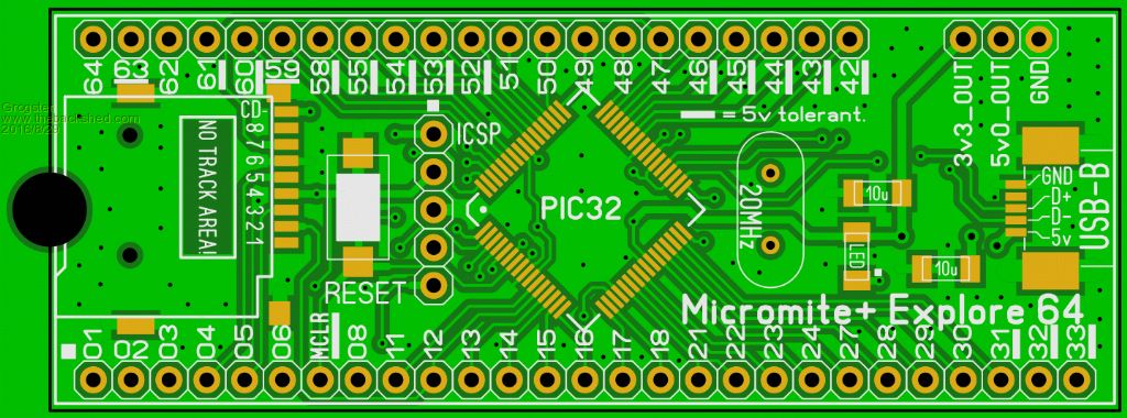

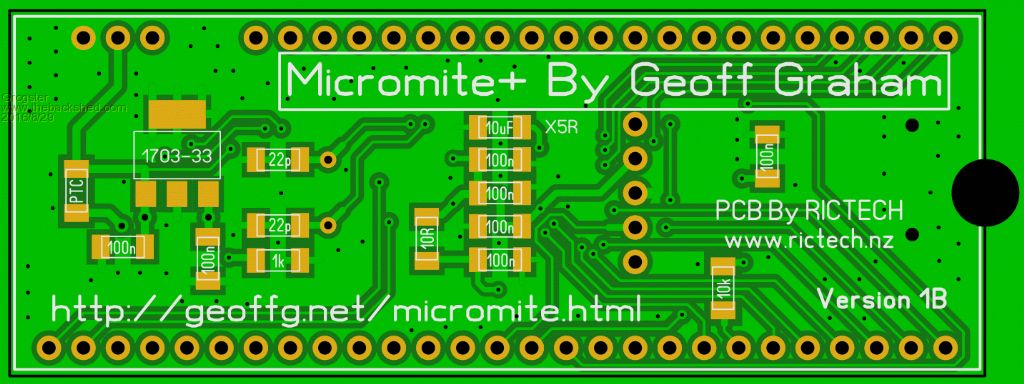

Posts: 10109
Posted: 01:31am 29 Aug 2016
PCB version is 1B if there is no USB jumper - J1. It should be this one here:
This version of the PCB does NOT have the supervisory IC on the PIC32 MCLR line, so it won't be interfering with the SD card operation. At least we can rule that out.

  WhiteWizzard said  One question, is the SD card / Touch issue occurring on either SD socket, or only on one socket?
Any clues here?
