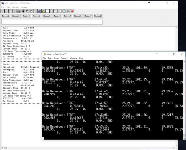

Posted: 06:33am 16 Jul 2016
Thank you so much Grogster (and JohnS)
I finally got it working
EDITED:
I'm a bigger idiot than I thought I was
I had the wiring of the com ports on BOTH micromites wrong!!!!!
I totally forgot that while Tx means an output from the Micromite
TX on the HC-12 means data OUT
I had it the other way round, I was connecting tx to tx like a fool and I did the same on both boards
Me thinks it's time for the Chinese to make some more money for new boards!
The white data is what the Transmitting micromite is sending but as a string of just the data
The black data is the receiving micromite working
Edited by lew247 2016-07-17
