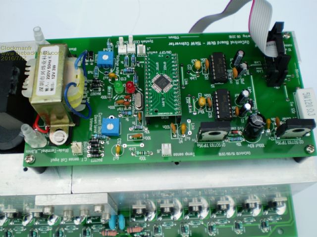

Hi Clockman,
It is reassuring to here I am not the only one, I actually have that 2uf capacitor connected in the photo. It is the 2 black wires going off to the right, I will find some where to screw it to the case when I get to that stage. Also you will see the 2 N4007 Diodes connected to the output of the transformer sitting up at an angle, I had to drill new holes for them. You can see the transformer I have used which is a PCB type would be a better option in my opinion.
That part of the board certainly needs some rearranging, there is space above and below the transformer that could made better use of. After I get this one up and running I plan to do a version with an Arduino which I will use for sensing current, voltage, temps etc. This will then control fans, over temp shut down (or possibly partial shut down first of non essential loads). Other option I am thinking of is data logging and connecting it to my network, this will allow graphing of variables etc which is quite easy to with the Arduino.Edited by Madness 2016-07-12

Originally I made the first OzControl board 6mm longer, then I found out that nowadays the PCB manufacturer prices on size.
As you can see in this photo I have lifted the Isolation 220vac to 12vac transformer on to 4mm high spacers for this particular board and that is what I will recommend.
The 2uf capacitor is on and firm, but just looks untidy. Some time I will give the board another 6mm in length to be more pleasing to the eye.

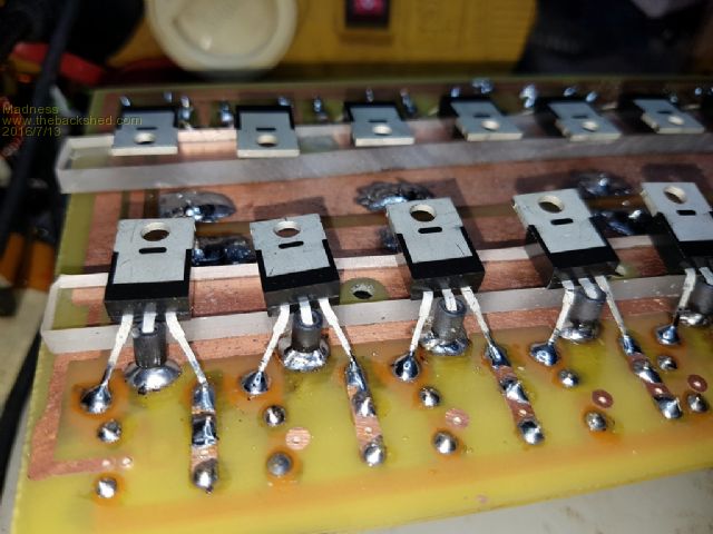

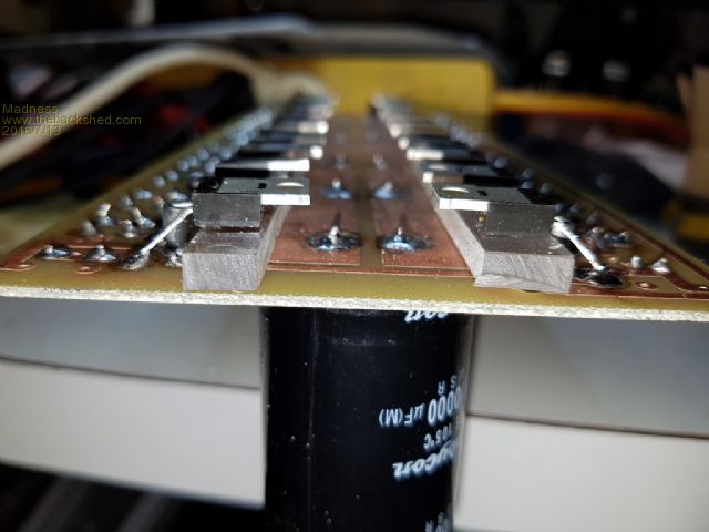

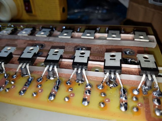

Have made a bit more progress after getting PCB etching sorted out.
Here is how I have mounted the mosfets so that they will clamp onto the larger Aero Sharp heat sink. The perspex that I have used has a working temperature rating of 80 degrees continuous and up to 120 intermittently.

Posted: 09:47pm 12 Jul 2016

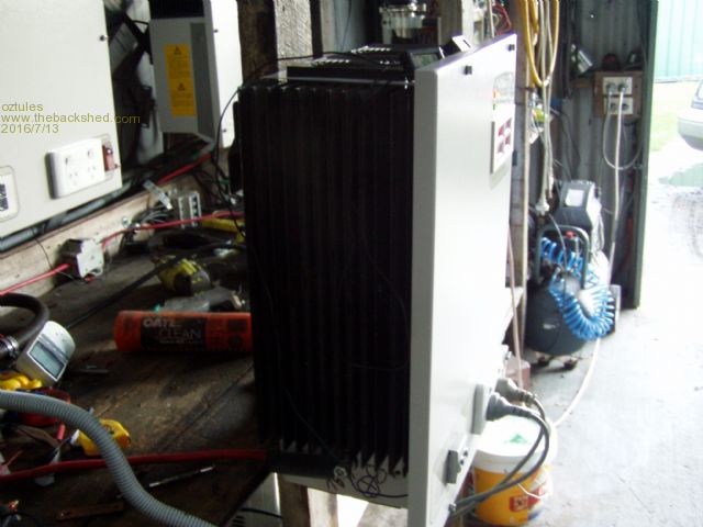

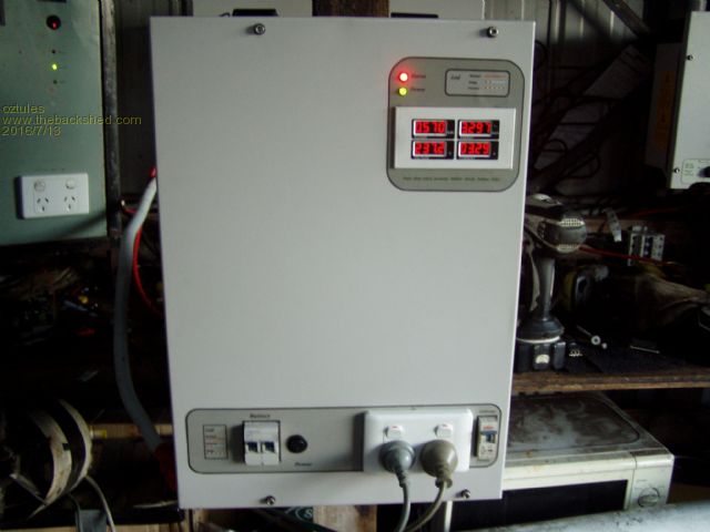

Mad... here is the 3kw aero with the inspire heat sinked board ( modified clockman board.
No fans, and testing showed today that 2.5kw for 1 hour raised the heatsink 18 degrees above ambient, transformer was 30 degrees above ambient.
I have set it for 5kw cut off... instant loads far higher.
Needs further testing when there is some sun to replace the electrons I waste.
...........oztulesEdited by oztules 2016-07-14

Posted: 12:34am 13 Jul 2016
Yes labels are from A4 label paper, then A4 clear label sheet.
It makes a very strong, and chemical resistant surface.
The transformer you have made is many times better than the one I built for this one.
I only wanted a 2-3kw continuous with no fan, so it is only having to support 10-15 amps so secondary is 6mmsq, and primary only need do 60 amps so 35mmsq. It has massive surge if needed, and would run 4-5kw for 30 mins I guess, still need to test this.
Yours is very much superior, and this is only a test bed to try different thermal ideas... like the massive heat sink.
Clockmans board is bigger than yours, so yours would be better for this topology, but Clockmans is very solid, and could easily cater for many blow ups without a problem with fiddly tracks... and this one should blow up I expect... that what test beds do I guess.
Also, this system we are using is very fast to pull the heat sink and fet board out to repair.. probably 5 mins tops.

I kept the fets very close to the surface without spacing so that the legs are very very short, and only the wider parts are used really.. better current carrying I think, but no room for ferrites on the center leg...... does not seem to bother it.

I had wondered about he legs on the mosfets and their current carry ability. Can beef up the legs by soldering extra wire to them, Removing the ferrites and spacer is an option too if they make no difference. It was a pain in the arse soldering them in like that with the ferrite on there, plated through PCB would have made it much easier. Also I will build a future version with the 247 version of the mosfets. This board is a bit rough, I want to test it before getting some more made.

I think that the heat sink need not be complicated, as the heat does not transfer as well in that configuration... direct is better I think.... learnt that when I did the linear power supply for 80 amps..... serious losses there.
In this case, I found enough room with just the fet case for clearance....hence all the 4mmsq wires involved with it.
