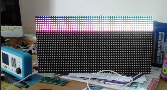

Got the RGB matrix earlier today and all working reasonably well.
One observation with my panel here is that I am experiencing some vertical 'bleed' under certain conditions - and I am curious if anyone else is seeing this.
Can I ask anyone with a 64x32 RGB matrix connected to a MM to try: LINE 0,0,0,0,1,RGB(WHITE) and see if the 15 pixels below the illuminated pixel (i.e. below top left pixel) are 'partially' illuminated. Note to CLS first.
The strange thing is that if I draw a horizontal line, then I get no bleed below a single pixel.
I have a feeling it is to do with the unit's multiplexing circuit and power circuit (and nothing at all to do with matherp's excellent driver code).
The above 'bleed' occurs with all three R, G, B colours - white just highlights it better.
This 'bleed' only affects the 15 other vertical pixels in either the top half, or the bottom half of the panel in the 'column' that the single illuminated pixel is in. So if the 28th from top (single pixel) in the first column is illuminated (i.e. LINE 0,27,0,27,1,RGB(WHITE)), then the 4 pixels below it, and the 11 pixels above it are showing signs of 'bleed'; and the top 16 pixels (top half of panel) are all 'off' with zero bleed.
Any feedback would be useful to see if it could be my panel at 'fault' . . .
WW

Posts: 12176
Posted: 06:08am 13 Jul 2016
  Quote  Is there any 'brightness' control possible with this panel
There are 4 brightness levels for each of the LEDs, off + 3 other
so rgb(64,0,0) is a dull red, RGB(128,0,0) is mid level and RGB(192,0,0) is full bright red.
i.e. the colour map is RGB222
To get panel level control you could maybe OR the R1,G1,B1,R2,G2,B2 signals with a PWM'd output: UNTESTED
  Quote  I am experiencing some vertical 'bleed' under certain conditions
I can only suspect this is to do with the switching of the mosfet drivers and some sort of capacitance effect so when only one pixel is lit at the point of switching to the next row there is some energy stored in the system which then partially illuminates the next row until the stored energy is used up

Posts: 2998
Posted: 08:24am 13 Jul 2016
@lew247
Don't worry about setting up a test - matherp has provided an answer which I believe to be the case.
If I light more LEDs then no issues - but am testing thoroughly so may find other 'niggles'.

Posts: 12176
Posted: 09:56pm 13 Jul 2016
The driver is RGB222 so anything 0-63 is off, 64-127 is dim, 128-191 is medium, 192-255 is full bright. i.e. just the top two bits of each colour have an effect.
The way the driver works is as follows:
The 16-way multiplex happens continuously but within it there is a cycle of three where the program displays top-bit, top-bit, second-bit.
So for 192 each cycle is ON
for 128: 2 out of 3 cycles are on
for 64: 1 out of 3 cycles are on
for less than 64: no cycles are on
To check the "bleed" I used re-wring my panel as an excuse to develop the 100-pin version attached below.
Using this I can confirm there is no bleed on my panel and the brightness levels definitely act as described above. The difference between 128 and 192 is not great but definitely there.

Posted: 12:11am 14 Jul 2016
  Quote  Is the 64pin code definitely the four-brightness levels version of the code?
WW
Try this version (untested on the 64-pin but works well on the 100-pin) which is now RGB333 (8 steps of 32) and I've tried to get the perceived brightness changes more linear.
I've also updated the 100-pin version in the previous post to RGB333

Posts: 2998
Posted: 01:06am 14 Jul 2016
Thanks Peter - give me an hour or so and will get back to you . . .
Posts: 2998
Posted: 01:46am 14 Jul 2016
WOW! It is so clear now to distinguish the brightness levels.
Here is a photo of all 512 colours
Poor Photo - sorry; but looks really 'colourful' now when viewed 'in the flesh' .
One question; can we daisy chain two panels to give a 64x64 OR will there be a detrimental affect on 'flicker'?
Thanks once again . . . .

Posts: 2998
Posted: 01:55am 14 Jul 2016
@MicroBlocks
I was thinking of doing something like that - just be good if 2 panels (64x64) could be controlled by one MM.
Currently this is 64x32 x 512 colours and FLICKER FREE to my eyes which is fantastic.
Once again Peter M has created a 'masterpiece'
Will try and find SLR tonight and post a better picture (maybe Full HD by tonight with the speed Peter works!!)
