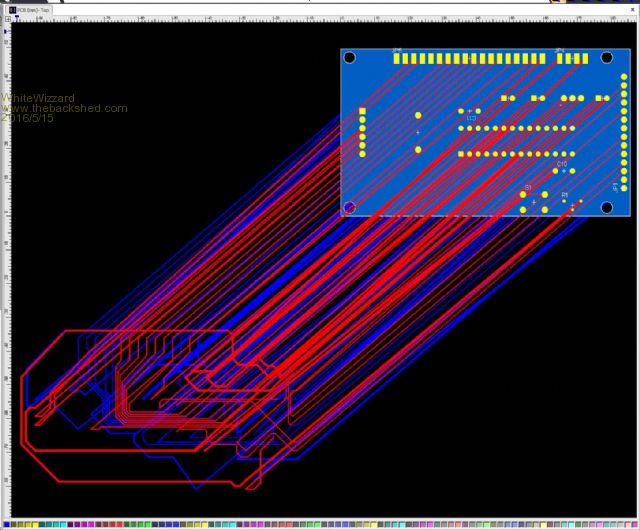

  Geoffg said  For a demo PCB you could use the Micromite LCD Backpack as featured in Silicon Chip (the PCB copyright is mine and I placed the design in the public domain). Less than a dozen components and reasonably simple (just three vias).
I did try importing the .brd file into DEX but the first message I got was that the files were not Eagle 6 format. So passed it through Eagle 6 and saved them in E6 format. Then had offset tracks from the PCB and silkscreen within DEX. No matter what I tried I struggled.
Has anyone out there been able to successfully 'import' Geoff's design into DEX?
I have tried both the GL version of DEX and the non-GL version.
Appreciate any words of success out there with Geoff's .brd file . . . .

  bigmik said  Sorry, but not ever using eagle I don't know.
Please try two things if you can (and no problem if you've never used Eagle as you're simply using DEX's Eagle file import feature):
1> Try importing Geoff's .brd file he has published (this is where I got an Error saying wrong version number - i.e. not an Eagle 6 file)
2> Try the attached file (Geoff' file converted to Eagle version 6)
2016-05-15_232613_2.8_BackPack_DEX_Test.brd.zip
Thanks . . .
Posts: 2998
Posted: 01:31pm 15 May 2016
This is what I end up with:
EDIT: Holes and track-offset issuesEdited by WhiteWizzard 2016-05-16
Posts: 2984
Posted: 02:04pm 15 May 2016
GDay Phil,
I get exactly the same.. Can you do the sch file as well and I can send them to Iliya for his thoughts?

Posts: 2998
Posted: 02:42pm 15 May 2016
Mik,
.sch file in E6 format . . .
2016-05-16_004220_2.8_BackPack_DEX_Test.sch.zip
Posts: 2984
Posted: 04:34pm 15 May 2016
Hi Phil,
It made a difference in that I could move the top right hand stuff down.. I didnt do it perfectly but it is almost right.. I will forward it onto Iliya for his input.. There must be some minor `registration, error..
I notice that the top screen text is imported to the Documentation layer.. Easy enough to move to the correct layer but not worth doing till the import is fixed.
2016-05-16_023416_test_backpack_28.zip
Kind Regards,
MickEdited by bigmik 2016-05-17
Posts: 2998
Posted: 08:55pm 15 May 2016
  bigmik said  It made a difference in that I could move the top right hand stuff down.. I didnt do it perfectly but it is almost right..
I was able to do this without the .sch - but the 'control' over the movement was very erratic. I group selected the top right stuff (i.e. the PCB, pads, silkscreen), and dragged it towards the tracks. But as I came to stopping the 'drag', there seemed to be a 'continuation' (a bit like steering a boat on water), so getting accurate placement was impossible.
Will be interesting to see what IIlya comes back with - hopefully something silly I am doing

Posts: 2984
Posted: 10:59pm 15 May 2016
@WW,
I suspect you had the sch file in the same directory.. I found everything loaded exactly as you showed but when I moved the block with the PCB down to the tracks the tracks disappeared and the schematic was blank, this was not the case when the sch file was loaded (they load together if they have the same name and in the same directory). There is obviously some minor issue with the import and coordinates for each layer, have you tried other boards at all? Also can you try setting the origin before saving to eagle 6 format.. Not sure what or where to set it too..

Posted: 03:47am 16 May 2016
I can confirm the 'odd behaviour' and could not help myself just inspecting the .brd file. From .brd when imported and looking at the white board outline, the 'origo' appears to be lower left corner, DEX shows this as (0,0).
Inspection of the Eagle .brd file which looks like being xml style, with quick scan of 'wire' coordinates shows negative values of x and y. Meaning placement outside the board outline.
I was going to do a calculation of the offset vector for the top and bottom layer (guessing red and blue means top and bottom) but decided against it as I don't know anything more than the name about Eagle. I think it is a simple fix for the makers.
I really just wanted to see if I could manage to import from files downloaded from the forum topics. I survived the little exercise. Edited by plover 2016-05-17
