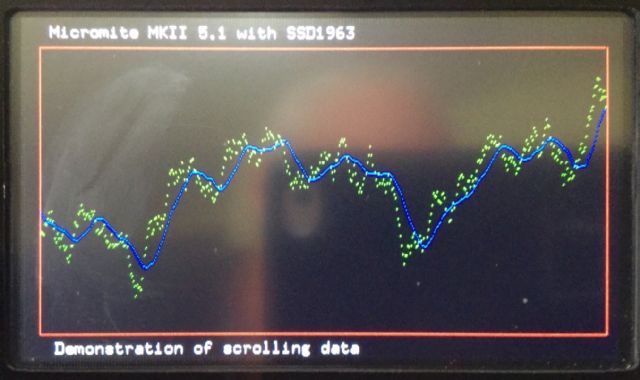

Peter, I think I'm getting there... The attached is thanks to your help in several different areas, I'm sure you'll recognise the derivation.
And yes, I would have completely missed the GPS solution. Back to work...
