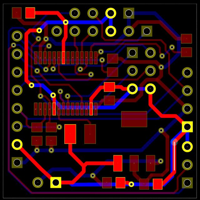

Posted: 04:03am 26 Apr 2016
After viewing some of the videos i can see the value of this software package.
Some of the things that are laborious to do in Diptrace you can do pretty simple.
Especially dragging pins around and changing the component layout in the schematic is very useful.

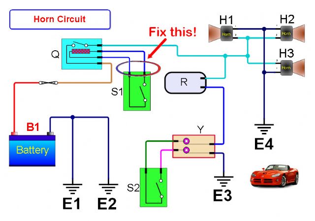

I did not see any samples with uses colored lines in the schematic and same colored traces in the PCB. For me that is one of the useful features i would like to keep.
Posts: 2984
Posted: 02:24pm 26 Apr 2016
Hi Jean,
Yes DEX can do colours as you like in DipTrace, even better IMHO
See this schematic of a HORN circuit for a car.
If you have joined the Autotrax DEX forum you will find this thread that I created asking that very question.
Colours in Schematics Thread

What would save me a ton of time is when assigning a color to a net in schematics it also appears on the PCB layout.

When you select a Net either in the Schematic or the PCB all nodes on that NET will be highlighted in both the Schematic and PCB. In the case of the PCB the other NETs will DIM so that the net in question stands out.. Great for manual routing.
See this screen shot
