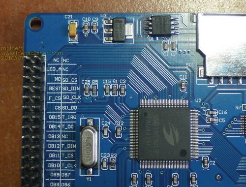

Will using the 25Q chip mounted on the LCD and connected to an MM2(+) be a problem as its SPI2 that is wired to the Touch and SD card on the MM2(+) boards? The manual indicates that SPI2 would not be available to Basic, so does the 25Q need to be wired to SPI.
Gerry
F4 H7FotSF4xGT
Posted: 01:28am 07 Apr 2016
  Quote  Will using the 25Q chip mounted on the LCD and connected to an MM2(+) be a problem as its SPI2 that is wired to the Touch and SD card on the MM2(+) boards? The manual indicates that SPI2 would not be available to Basic, so does the 25Q need to be wired to SPI.
The code just needs re-compiling for a MM+ to use SPI2.
MM+/SPI2 version attached (including Microchip support):

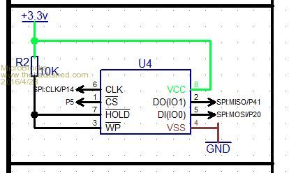

I have added a winbond chip footprint to my 44 pinner module and i would like to ask you if i can get away with using a single 10k pullup resistor for both the HOLD and WRITE PROTECT pins. Space is getting tight and dropping a resistor gives just enough room for the traces.
I think it is not a problem. Not much is mentioned in the datasheet, i even think i can directly connect it to VDD as both pins are probably only input pins and will not draw much current. I don't have a chip in my possession yet so i can not test it at the moment.

This is how i wired them in the schematic.
If you could do a little test that would be great as i don't have the parts yet.

  MicroBlocks said   This is how i wired them in the schematic.
I don't see why you use a pull up on ~HOLD and ~WP: these could be tied up directly to Vcc.
On the other hand, there should be a pullup resistor on ~CS, so that on power on and before the Micromite pins are properly configured (and thus the CS pin properly driven), there is no risk of spurious writes to the flash chip, due to floating pins.
Posted: 11:54pm 27 Apr 2016
Peters configuration was with a pullup on both ~HOLD and ~WP. The datasheet does not specify if a pullup is needed or if it can be tied to Vdd directly, hence my question as the only way to find out is to test it.
The snippet from the schematic has to be changed to work correctly.
I agree about the pullup on the ~CS, i not like floating pins at all. It could be however that that pin has an internal pullup. Back to the datasheet again.....

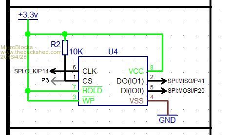

Posted: 12:05am 28 Apr 2016
  Quote  At the moment, I am treating them like EEPROM chips and assuming they have internal pull-ups, meaning that WP can be left floating, and just pulled down to deck to enable WP mode.
I'm pretty certain when I was doing the development I tried this and it didn't work - a proper external pullup was needed, either resistor or tied to VDD.
  Quote  I don't see why you use a pull up on ~HOLD and ~WP: these could be tied up directly to Vcc.
Agreed: I just think it is good practice to always use a resistor - just protects the chip and makes it easier to connect a uP pin at a later date
  Quote  On the other hand, there should be a pullup resistor on ~CS, so that on power on and before the Micromite pins are properly configured (and thus the CS pin properly driven), there is no risk of spurious writes to the flash chip, due to floating pins.
Agreed
Posted: 01:05am 28 Apr 2016
Ok, i have updated the schematics.
The datasheet does not mention an internal pullup on the ~CS pin.

...the bloody datasheet does not mention the requirements for pull-ups at all on any pins, and it is something that really should be there in the PDF. The fact it was missing, made me think that it must therefore have internal pull-ups, and you don't need to worry about them. If it was important, they would have written about that in the datasheet.
False logic?
Perhaps.....
I use jumpers or solder-blob pads to pull WP to deck(ground) on the I2C EEPROM type chips pretty much as standard design, so that you can choose between writeable and write-protected modes easily later, and this concept requires pull-ups rather then direct connection to supply(or you would short out the supply), unless this is documented and allowed for in the PDF(device has internal pull-ups kind of thing).
Again, if the datasheet was to have been kind enough to have enlightened us on that aspect of the device, that would have been nice.
My design will therefore use three 10k pull-ups: WP, HOLD and CS.
I have space, but I realise this is not quite for you, MB.
@ matherp - did you have pull-ups on the data lines, or just WP, CS and HOLD?Edited by Grogster 2016-04-29
Posted: 02:45am 28 Apr 2016
There is one hint in the datasheet:
WARNING: if the /WP or /HOLD pins are tied directly to the power supply or ground during standard SPI or DUAL SPI operation, the QE bit should never be set to a 1.
The QE bit stands for 'Quad Enable'.
If that bit is set then the /WP and /HOLD pin will be IO pins that can cause a short.
That is settled then. Use a pullup resistor on each one of them.
Bummer, now i have to find some more space......

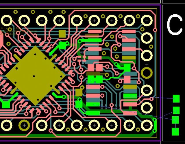

Posted: 03:03am 28 Apr 2016
Now to squeeze in those two resistors.
Not much room to play with.
I will have a look at those arrayss.
I need five resistors. two for the I2C pullup, and three for the winbond chip.
It might be possible as i can move the I2C pullups to another area of the PCB.
Oh boy, this is going to be some rework....

Posted: 04:07am 28 Apr 2016
Yeah those are a great find.
I was looking but somehow my google fu is letting me down a bit this week.
Not only a great space saver but also when placing it, it is much more easy and less time consuming. One placement instead of four.
My concern now is that i planned on those parts to be optional.
The memory chips are soic's so still not to difficult to add later. I am not sure about the resistor array, although it looks like the spacing is about 0.5mm which is not too bad.
edit: I did get those two extra resistor squeezed in, but now i am intrigued by those resistor arrays as they can be a real timesaver.
