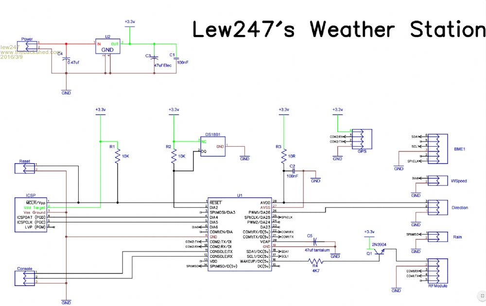

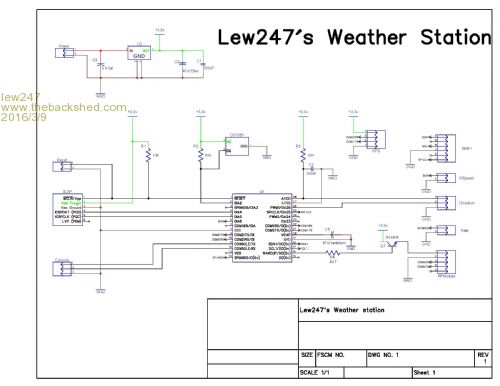

2016-03-09_145026_Weather2.pdf Can someone (or more than one person) check the circuiit diagram and see if I have made any stupid errors?
The main thing I need checked is the circuit around Q1
I decided to power the HC-12 433M Mhz transceiver module from a pin on the Micromite via a transistor
I did this because being battery operated it will cut down on the current consumption as it can be powered up just before it needs to send a data burst and then powered down afterwards
Is this a good idea or a bad idea?
Attached is the modified circuit diagram Thanks to microblocks for helping me get it much neater and tidier than I could ever do
Also - should I have the DS18B20 mounted ON the board, or have it as a header so it can be mounted elsewhere in the outdoor unit not near any possible heat source?
The picture's a bit small so it's attached as a pdf

Also
Can Someone please PLEASE check the TX and RX pins for the
console
COM1 to RF module pinouts
and
COM2 to GPS pinout on the circuit please
I need someone to check my diagram and make certain the tx and rx tracks are in the correct place
Please
Thank you
Lew
Edited by lew247 2016-03-10

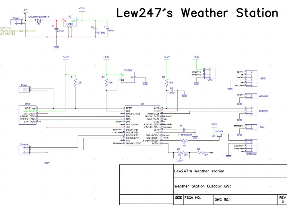

Update:
I've decided on the final circuit for the outdoor unit:
Thanks to microblocks for making the circuit so neat and tidy, I could never have done that myself, I had wired crossing all over the place.
The outdoor unit will not comprise of:
Micromite
GPS unit - for setting the clock on the inside unit, and also in case the outdoor unit gets stolen it will transmit it's location.
BME280 Temp, Humidity and Pressure sensor
DS18B20 for Temp as it's more accurate than the BME280
HC-12 Serial tx/rx 433 Mhz transceiver module
Wind, Speed, and Direction sensors
Console header
ICSP header
Reset header
and 1A 3.3V regulator
Battery monitoring circuit, as the battery is a 5V solar charged battery, it will measure the voltage and send it to the indoor unit so I can keep an eye on the battery and make sure it's charging correctly and doesn't get too low.
Both the HC-12 and the battery monitor is powered via the micromite to cut down on current consumption, they will only be powered on when needed.
Circuit below and the Diptrace ciruit is attached as well if anyone wants to see it.
As to the code for the outdoor unit, I have all the various sensors working perfectly now, all I have to do is combine the various codes into one program and test it, which I can't do till I get a unit made up so I can power up all the modules at once.
I used a micromite+ while I was writing the code and checking it worked, but when you add all the modules the 3.3V regulator on the micromite+ isn't able to handle the current (don't ask me how I know..... yes I damaged mine!!!)
I believe its only a 250mA regulator and the unit when all modules are powered needs a little more than that but well under 1A
2016-03-12_133740_Weather5.zip

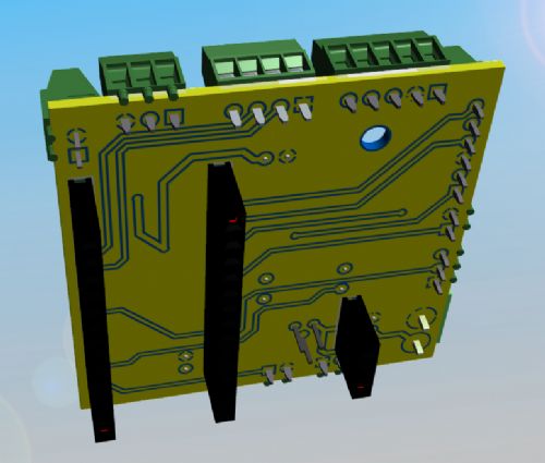

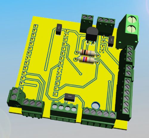

Posts: 2984
Posted: 04:25pm 12 Mar 2016
Hi Lew, MB, All,

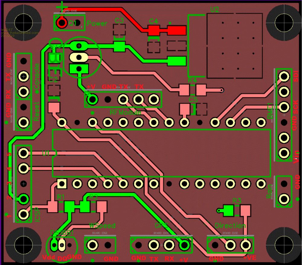

I had done a plug in board to suit a MuP and only needed to add the text overlays.
But what has actually changed in your new schematic? And can you please upload a new hi-res version?
I am not sure whether it is best as a plug in or as a standalone as per MB's board..
There is a problem with MB's if you want to use the screw terminals as these are about 6mm deep so some would interfere with some other components (esp. the right hand connectors, they would hit the pic chip.) They are, however perfect for pin header pins.

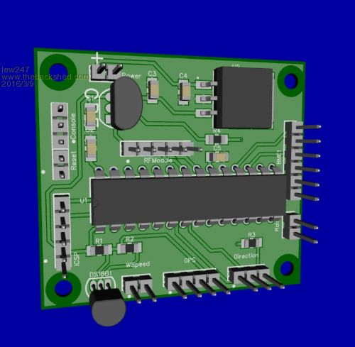

For what it is worth and for the point of discussion I have attached the MuP-Weather 3D pics here. These are using 2.54mm pitch screw jacks for all except the Power IN which uses 5.08mm.
Posts: 2984
Posted: 04:34pm 12 Mar 2016
Hi Lew, MB, All,
Note the 3D jacks are close but not identical to the ones I actually have (the images I got for the 3D have plastic location pins mine do not) hence they look a little strange in the views.
MuP-Weather is 49.5mm x 49.5mm (can layout 4 to a panel for manufacture) and plugs into MuP via the 3 female headers on the underside.
The board is offset to allow access to the ICSP and CONSOLE headers on MuP, although there is a console screw jack as well..
The board can be smaller if we wish to go down this path as ICSP header can be added to MuP-Weather and we dont need access to MuP's console..
Anyway, Personally I am leaning towards MB's all-in-one board with some adjustments to fit screw terminals

Hi res picture Edited by lew247 2016-03-14
lew247
Joined: 23/12/2015
Posts: 1709
Posted: 07:22am 13 Mar 2016
Thinking about it the only thing that could improve it is the DS18B20 being mounted off the board, but thats easy enough as it is, although a 3 pin header would probably be a little neater.
The board as it was the last time Microblocks did it was 50 X 44 but it doesn't actually have to be that small if it's an all in one unit. a little bigger won't hurt at all
I did try routing it myself earlier but had to give up after 4 hours on it.

The best I have managed to get is a board 90mm X 80mm but I need to move 2 traces sllghtly to the left but I have no idea how to get at the bottom of the board to move the traces
(it was done with the autorouter)
Made one FINAL change tonight
Added a header for a LUX/UV index sensor and the DA18B20 is on a header so the sensor can be placed where its needed.

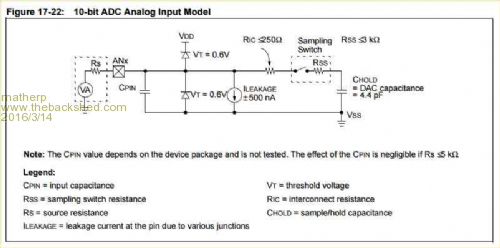

Posts: 12185
Posted: 05:18am 14 Mar 2016
The model of the ADC input is as below:
You will note there is a +/- 500nA leakage and the pin capacitance to take into account at all times. When the sampling time is started the input has to charge the 4.4pF capacitor.
The sampling time can be set in software but in the Micromite firmware is fixed at a "normal" level.
Page 275 of the PIC32MX170 datasheet gives a recommended source impedance of 5K.
