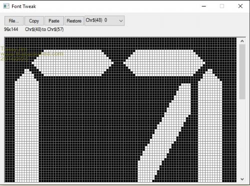

Just downloaded a 128x192 font from 'RinkyDink' and the editor screen in your app doesn't fit on my screen due to its big size. The issue is there are is no vertical scroll bar to see/edit the bottom part of the characters.
Sorry for multiple Posts - but feel it best to post each issue separately as and when I find them.
WW

Posted: 12:46pm 25 Feb 2016
I have started work on the scrolling area.
Paste will no longer paste if there is nothing to paste.
I will eventually add the ability to add another character to the end of the existing characters
Jim.

Posted: 07:43pm 25 Feb 2016
Scrollable area to allow for Phil's grand designs.
Also:
The 'insert' key adds a new character to the end of the set.
'delete' deletes the last character in the set - NOTE not the current displayed character. I will change that to only delete it if it IS the current character.
NEW now starts a blank set ready for 'insert'ing characters.
'insert' and 'delete' work on existing sets, not just new ones.
Please keep trying to destroy it. I don't have a TFT display setup to test the fonts on at the moment.
