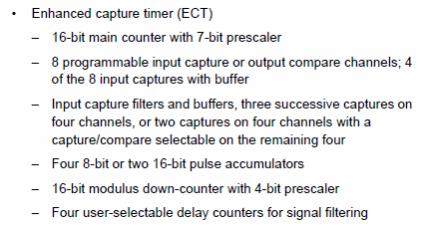

Agreed.. I would also like a "six pack" of them for the 6 pulse system needed... And it would all be done with hardware and interrupts... If they are 16 bit timers, I think the output voltage could be controlled nicely..
I would also need missing phase detection and rotation correction so that any combination of wiring errors wouldn't cause problems...
I wonder if there as a "basic" firmware core for the 6812 MPU..?? I sure would miss Geoff's working environment..!!
EDIT: Looking at the data sheet... Nice...
With 10 bit A/D's for sensing, this could just do the trick..!
And, I think I found a "Basic" compiler for it... More head scratching needed...

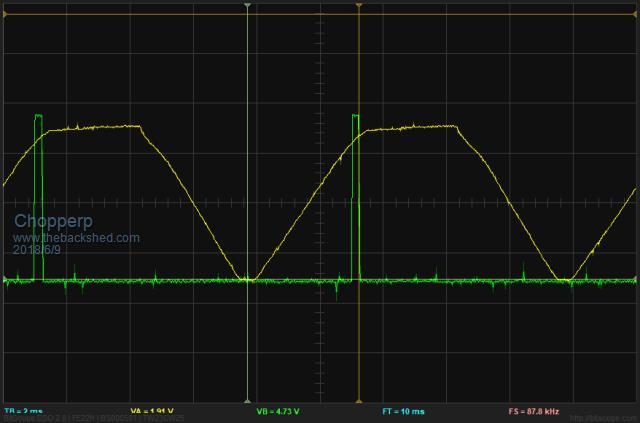

My requirements are simply for a trigger pulse for an SCR generated between ~ 1mS & 10mS after a 10mS trigger interrupt. The pulse delay needs to be proportional to an input voltage from 0 to ~3V.
The photo shows a short pulse being generated triggered after about 3.5mS from the zero point in the rectified AC wave. (We have flat topped Mains here in Aussie land). The pulse was generated using several PULSE commands which is not ideal.
Zonker wants to control 3 phase which probably means 3 pulses every ~8.3mS (60Hz), each shifted 120 deg in phase.
Hope this clarifies things a bit. Thanks for any help you are able to offer.
