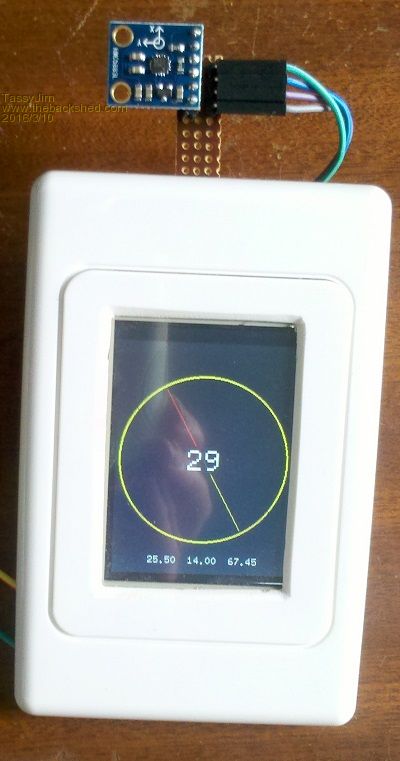

Speaking of which, this program draws a compass needle and gives bearing an the 3 components.
It requires a ILI9341 in portrait mode.
The HMC5883L is oriented with the x axis pointing 'ahead' or 'up' and the y axis to the left.

Posted: 05:36pm 09 Mar 2016
The sensor is mounted up front to be away from big hands.
Red points to magnetic north and the current bearing is in the centre.
The 3 numbers at the bottom are the three x, y and z vectors in uT
It is fun playing with a reed switch magnet in close proximity.
You can also point the 'compass' up (down in the northern hemisphere) to maximise the x reading and minimise the other two. This gives you the angle that the magnetic field is coming down at - about 70 degrees where I am.
At the maximum, I read about 56uT which compares reasonable well with the expected 61uT.
I will try it outside away from local interference sometime.
Compass combined with accelerometer is next on the list.

Posted: 08:38pm 09 Mar 2016

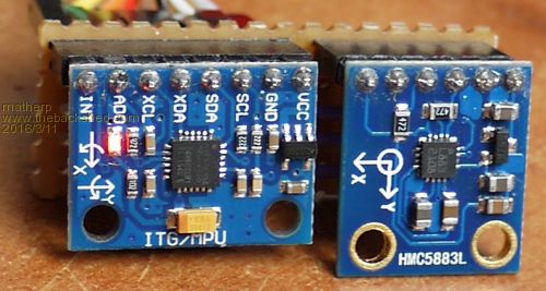

I think your sensor might be upside down compared to mine.
When you rotate, does the red end of the compass needle stay pointing north?
After some reading, I have decided that there is no need to scale the Z axis any different to the X and Y axis's.
I will update the program with a different set of gain figures.

Posted: 08:53pm 09 Mar 2016
I re-read your post.
If I keep the sensor in the same location, it behaves correctly but if I hold the display in the same location and therefore move the sensor around in a circle, I get strange results. This is because I am too close to mag fields. A long power lead and standing in the clear will work better.
Keeping it level makes a difference too.
The 'case' is a blank electrical power outlet.
I don't have the luxury of a CNC miller but the Dremmel and a shaky hand does a reasonable job of cutting the opening.

Posted: 08:57pm 09 Mar 2016
  palcal said
I also meant to ask why an accelerometer with a compass.
Paul
An accelerometer gets your tilt/inclination. Together you can calculated the mag field in 3D.
We 'should' be able to end up with a compass that works on any angle.
palcal
Joined: 12/10/2011
Posts: 2054
Posted: 10:10pm 09 Mar 2016
I had my compass outside well away from any interference when it was reading incorrectly. I also had it flat on a table so it was not at an angle.
Paul.
Posts: 12184
Posted: 11:41pm 09 Mar 2016
  Quote  I found a bug in the scaling factors for the Z axis when the gain is 4.7
Line 48 to 50 should be
CASE HMC5883_MAGGAIN_4_7
hmc5883_Gauss_LSB_XY = 400
hmc5883_Gauss_LSB_Z = 355
the Z axis was 255 - should be 355.
Also change it in the CASE ELSE section.
This gives a better maximum value for the Z axis.
Where are you getting these numbers from? The datasheet I'm looking at seems to say the scale is 390 in both cases
palcal
Joined: 12/10/2011
Posts: 2054
Posted: 10:14am 10 Mar 2016
With the latest code North is showing at about 40 Deg. When I rotate, the red line also moves by about 40 Deg.
Paul.
Posted: 10:47am 10 Mar 2016
I found some Arduino code from Adafruit. Most of the other code I found on the net seemed to use it as a base so I converted it.
My later code posted here uses the values from the data sheet with Z the same as X an Y.
I am still not sure where the Adafruit code got its figures from seeing they had the datasheet.
palcal
Joined: 12/10/2011
Posts: 2054
Posted: 06:30pm 10 Mar 2016
@Jim,
I also see that when pointing North the heading can read either 360 Deg or 0 Deg.
Should it not be one or the other.
Paul.
Posted: 07:21pm 10 Mar 2016
After:
heading = INT(DEG(Atn2(yh,xh))+.5)
add a line:
if heading = 360 then heading = 0
I have been trying to add compensation for tilt but not very happy with the results.
Two application notes from Honeywell give conflicting information.
I am using a MPU6050 to get the tilt OK but the formulas for correcting the X and Y mag readings don't seem to give me acceptable answers.
I think I will have to give it a rest and work on something else for a while.
Posts: 12184
Posted: 10:34pm 10 Mar 2016
Attached is a full AHRS implementation using MPU6050 and HMC5883 you may recognise some of your code in there
The issue I'm not sure of is the relative relationship of the x, y and z axis of the two sensors in the call to the sensor fusion routine
MahonyAHRSupdateMag(gx, gy, gz, ax,ay, az, -my, mx, -mz)
I'm using x=-y, y=x, z=-z and it seems OKish. I've also got a version for the MPU9250 but bizarrely this chip is also a composite of two dies with the magnetometer separate and the axis aren't aligned in it either
