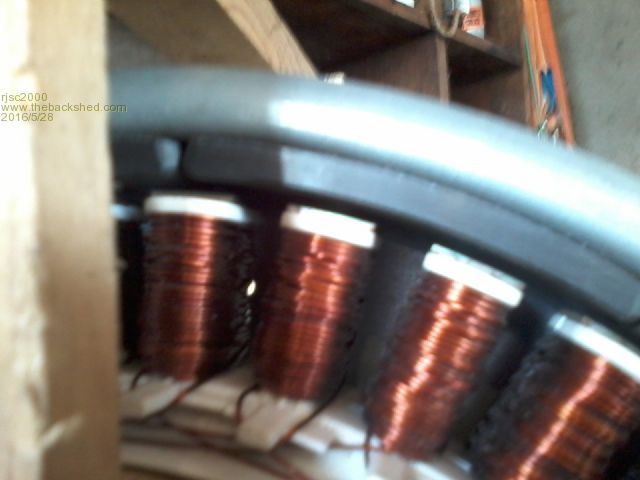

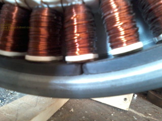

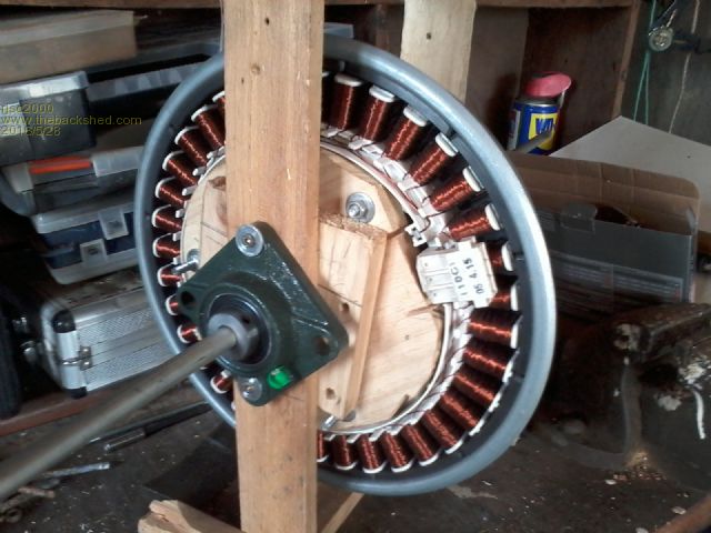

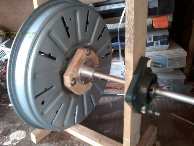

Posted: 10:14am 28 May 2016
  govertical said   Hi, that is the challenge. It took me more then a few tries to make it work. Don't give up, it can be done. Using the drive shaft as a alignment tool helps.
I can't put it centered enough so that it rotates easily. There's always some magnets that stuck to the coils.
Āt this point i'm ready to buy another set but this time with the shaft and other pieces or a full machine....
Here are some pictures

Hi,are you using the shim material to help with the alignment? Thanks for posting the photos.

Posted: 12:16pm 28 May 2016
Yes, but things weren't going well . And i've marked the place where the hub was and then secured it a few milimeters above, but it didn't work.
Maybe i'm using "small" stuff? The shaft is 12mm and the hub is not very big
govertical
Joined: 11/12/2008
Posts: 383
Posted: 01:06pm 28 May 2016
Hi, did you over size the outer diameter bolt holes so you can move the rotor a small amount?
rjsc2000
Joined: 17/12/2015
Location: Portugal
Posts: 13
Posted: 01:52pm 28 May 2016
Not with the rotor but with the hub itself.
govertical
Joined: 11/12/2008
Posts: 383
Posted: 02:31pm 28 May 2016
Shim
Hi, I just use a shim to center the stator to the rotor.
