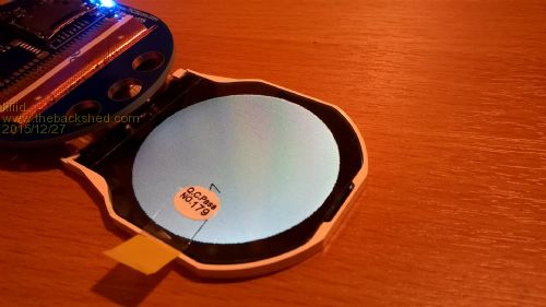

kiiid
Joined: 11/05/2013
Posts: 671
Posted: 08:34am 27 Dec 2015
Nothing again, unfortunately

@kiiid
Was looking a your round display Pix above... What kind of PCB is the display connected to..? I was wanting to order some of round R61505V based modules from Ebay, But it looks like you have one mounted to a PCB with some kind of plastic mounting frame for the display.. Is this your creation..? Looks like a SD card connector and other parts there... Just wondering...
I was hoping you got the new driver from Matherp running OK....

  Zonker said   @kiiid
What you see in the picture is a small board that I have designed for this display. It has a MM+, uSD, and a couple of other features. Since it is still in a very early stage, I can't announce any details yet.

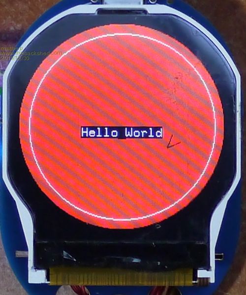

Posts: 12183
Posted: 04:36am 30 Dec 2015
  Quote   I thought the above driver was for the display and was now working
Zonker
The driver for the ILI9325 works on both 44-pin and 64-pin
This driver is similar but not the same as the R61505V. I've produced a driver for this but it is not yet tested.
It transpires there are two variants of the mounted display: the TFT1P2477 and the TFT1P4967 (both use the R61505V controller).
These need different wiring. I think Kiid's board is wired for the TFT1P2477 but the one he sent me has a TFT1P4967 mounted which I don't think can work irrespective of whether the driver is correct.
I'm communicating with him off-line and will update when we know more

Posts: 12183
Posted: 05:23am 30 Dec 2015
  Quote  Aaah, please don't say that!
I'm afraid so:
The banding is just an artifact of the photography

Posts: 12183
Posted: 06:35am 30 Dec 2015
  Quote  How did you get this one working? Using DB8-15, I guess, and high on pin 26?
Yes
Tested code for the R61505V is attached.
There is something strange about the way these displays address - I assume it is the same for all versions but it means I have had to do some address mapping in the CFunction. This is transparent to the Basic user except that MM.HRES and MM.VRES are both set to 230 although the display is effectively 220x220 (with the corners removed).
The only effect is that the centre point on the display is 110,110 for all orientations and not MM.HRES\2,MM.VRES\2
C Code attached. This includes conditional compilation for 44-pin, 64-pin, ILI9325, R61505V.
2015-12-30_163343_ili9325.zip
sub mm.startup
pwm 1,1000,50 'needed for backlight if implemented as PWM
R61505V_V64(PEEK(CFUNADDR R61505V_V64),2)
end sub

kiiid
Joined: 11/05/2013
Posts: 671
Posted: 06:50am 30 Dec 2015
Thanks a lot!
That was a priceless help
