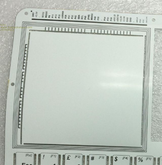

Posted: 04:48am 23 Apr 2016
I am particularly interested in the experimenting area.
looks like a grid. Do you have a closeup/schematic of that?
Edited by MicroBlocks 2016-04-24
kiiid
Joined: 11/05/2013
Posts: 671
Posted: 05:13am 23 Apr 2016
The schematic is on the panel. Well, almost...
There are 26 columns, each consisting of three linked groups of 9, 8, and 9 dots. The whole array is surrounded by four (only three are drawn on the panel) 'circular bus' lines.

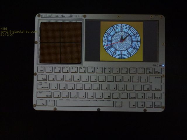

Pether's excellent Big Ben clock is the first program ever ran on my just assembled and now fully functional ELLO 2M laptop (still using the old screws as the new ones with smaller heads are on their way)

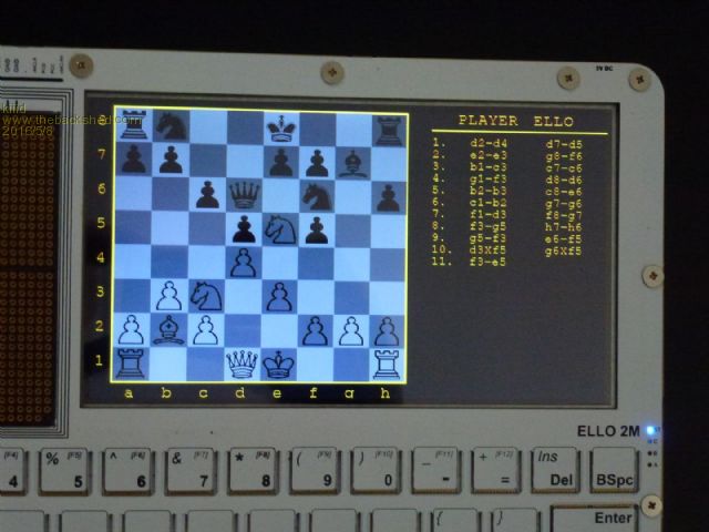

Another piece of ELLO software (still working on it, though...)
I think this is the first ever of its kind running on a MM-powered system
http://rittle.org

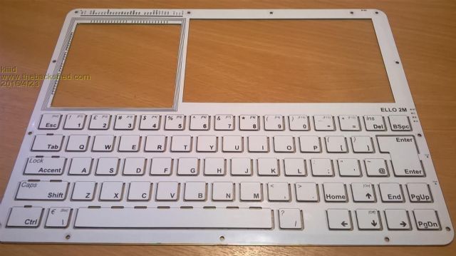

Is that a membrane keyboard or real buttons?
Kind Regards,
Posts: 2998
Posted: 09:10pm 08 May 2016
@bigmik
Kon has 'constructed' the keyboard by using the PCB layers of his solution. So he has five (or six) PCBs and uses the top layer as the key 'cap' (with the legend printed on it), and then some 'spacers' before the contact layer. There is enough 'flex' in the top layer to give a key-like feel to the overall set-up.
I was lucky enough to see an early prototype and will hopefully see this latest version in a weeks time
As Geoff has said - it is a brilliantly engineered solution and wish Kon every success with this product
EDIT: Kon has cleverly cut a specific shape around the top keyboard 'key-cap' to create the moving key 'button'. Hope this makes sense Edited by WhiteWizzard 2016-05-10
Posts: 2984
Posted: 09:17pm 08 May 2016
@WhiteWizard,
Hi Stranger, welcome back
I did notice some `slots' milled/punched into the top panel but I wasnt sure,
I gather 0.6mm PCB substrate would work out quite well, a novel approach that I have never seen before..
Thank you Phil.
Kind Regards,
kiiid
Joined: 11/05/2013
Posts: 671
Posted: 10:50pm 08 May 2016
0.6mm will be to rigid for this size of the keys. I had made the earliest prototype using 0.4mm, and it was too rigid as well. Currently I am using 0.25mm for the top panel, but my feeling is that 0.3mm is just about the right one for it.
http://rittle.org
f1fco
Joined: 18/03/2012
Posts: 155
Posted: 02:04am 09 May 2016
a beatiful work !
just a question : what is this Chess software ?
is it the code source available ?
is it for Micromite (with LCD screen) only ? or alson for Maximite on VGA ?
thank you for answer
Pierre, from Nimes, south of France
73s de F1FCO
kiiid
Joined: 11/05/2013
Posts: 671
Posted: 02:29am 09 May 2016
It doesn't use any hardware-specific references and will work on any MM+ system with 800x480 touch-screen LCD. It will not work on the Maximite because its Basic doesn't have the GUI commands.
This is not based on another chess program. I have written it entirely from scratch and will publish the code once it is fully ready (still working on its play strategy).
Edited by kiiid 2016-05-10
http://rittle.org
Posts: 2984
Posted: 04:30am 09 May 2016
@Kon,
0.25mm? 0.30mm? Boy that is thin, I used 0.8mm on my Nanomite and I thought it was very thin but you are talking less than 1/3 that thickness..
Wow again... I wonder how the longevity of it would be, any ideas?
