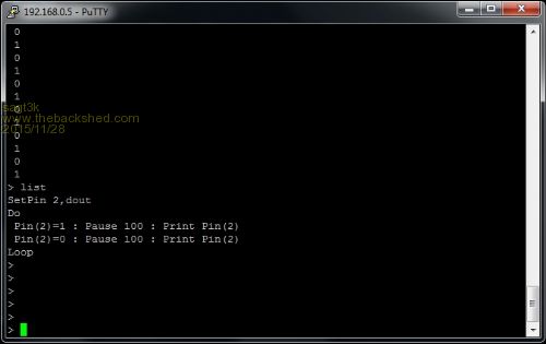

Posted: 10:02pm 27 Nov 2015
Practically Yes... I use Delphi to develop application.Delphi allow me to create a single executable file that can run on all Windows systems 32 and 64bit.
The service that I am developing for send bytes from the two sides, it will allow me to do many other things including handle DTR / CTS or GPIO UART (FTDI?, CP2102?). So for example you could use some pins of UART <-> USB to do a reset or a wakeup to Micromite. Here a example with Putty. If you see I'm connected to IP 192.168.0.5 with port 8282.

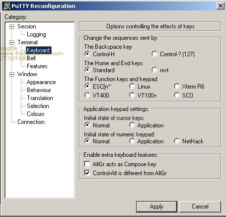

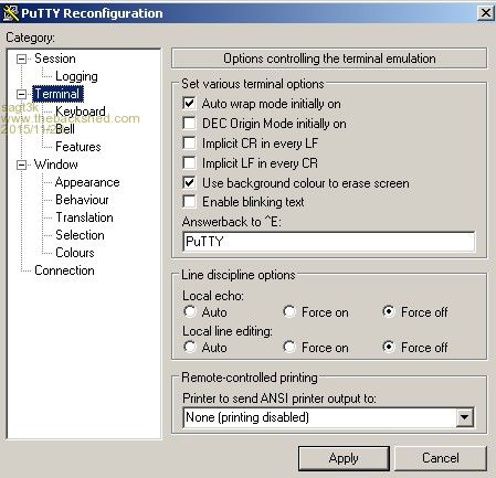

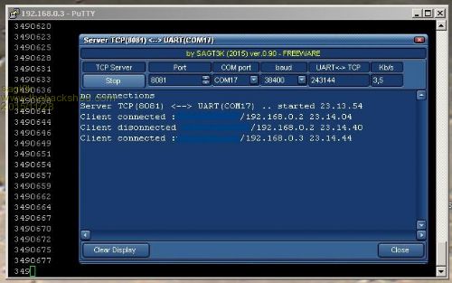

Posted: 12:53pm 28 Nov 2015
Hi Swissembedded and Jim
My application looks like MMlink. It's very simple. You start the application, set TCPport, set COMport (or by list or digit the COM), set baudrate and press START button. I use Putty for RAW/TCP connection. Here you can see images of application and putty settings. In attached my application with limited functionality:2015-11-28_225126_TCPuart.zip
