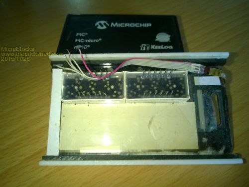

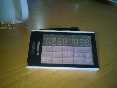

Posted: 08:09pm 27 Nov 2015
Thanks Geoff, it will make the search for the right controller easier.
I also could do it with a few analog ports.
I asked because there are lots of replacement touchscreens available for 1-2US$.
Making your own touch keyboard can be easily made by printing out a keyboard design and put it under the touchscreen.
Like this (a samsung touch replacement with two four digit 7 segment displays and a printed 'keyboard on a piece of paper):
The sides are acrylic strips. There is enough room for a battery and a small pcb with a umite and usb charging.
It is part of a long long project. :) ( A stepper motor controller that can repeat sequences)
Edited by MicroBlocks 2015-11-29
Posts: 3372
Posted: 12:18am 28 Nov 2015
Using a resistive touch screen on its own without a controller is not hard (eg, the TFT Maximite does not use a controller).
