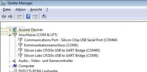

twofingers
Joined: 02/06/2014
Posts: 1785
Posted: 02:29pm 26 Oct 2015
  jeffj said  I understand that the mm should show up in device manager under "other devices"
There is no "other devices" showing up . I assume this is only displayed when something is found .
Hmm, can you confirm a installed Silicon Chips COM port driver?
Michael
