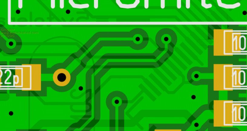

@ TZA - Like this?:
Posted: 11:24pm 05 Sep 2015
Yes. It is one of the last steps i always do when adding a copper pour.
Often moving a few vias can make a big difference.

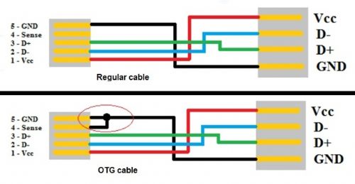

this just jogged my memory - is the pin between D+ and GND on the USB connector not used to sense an OTG (on-the-go, reversed master/slave) cable:
(from: http://tech.firstpost.com/news-analysis/how-to-make-your-own-usb-otg-cable-for-an-android-smartphone-29503.html
you might wish to route this sense pin to an input pin on the MX470, and use that to sense when an external USB keyboard is plugged in. at the same time you could replace the diode with a MOSFET (with internal bypass diode) that when turned on would route power out the USB port. all this would consume 2 i/o pins on the MX470.

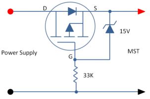

further reflection. the MOSFET should be wired up like this:
(from: http://www.ozqrp.com/rev_pol.html )
the zener diode and 33k resistor are not necessary, D goes to USB socket V+, S goes to 3v3 regulator input, G goes to the USB sense pin directly. there should be a 10k or so pullup from G to S.
when power is fed into the USB socket (from a host PC), the diode in the MOSFET will conduct. but the MOSFET will not switch on, as the gate is pulled high by the 10k.
when the 'sense' pin is tied low by the OTG cable, the MOSFET will conduct, allowing power to flow in the reverse direction, from E64 board back into the attached keyboard.
retaining the existing (external) diode may be desirable, as it my have a lower forward voltage drop than the one in the MOSFET.
rob :-)
Posted: 02:21am 07 Sep 2015
yes - a P-channel MOSFET. because it would be a rather small device and low currents are involved, the -5v gate voltage should suffice.
