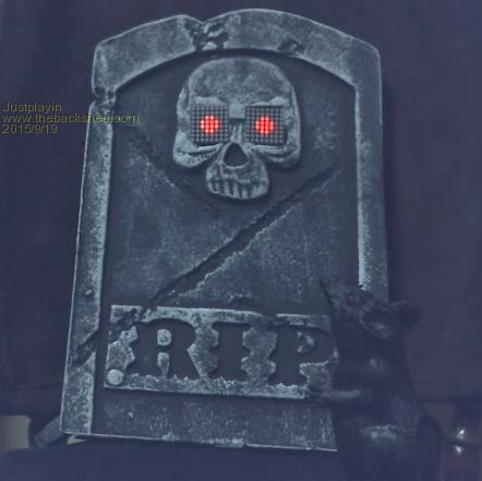

I am 99% done with my Halloween project. Just need to affix the MicroMite board to the back of the tombstone.
This the video of the Halloween Decoration. The program can be downloaded from Here.
First off, I am not a animator and do not use or know the proper terminology. Second, this program is not eleqant in its approach, it is animation by brute force.
A few notes:
-WARNING!!!!! Large amounts of DATA statements (animation steps) take a LONG time to load. My animation sequence is made up of 119 characters and 932 animation steps. On a Micromite 170 it takes almost 5 minutes before the animation starts displaying.
- When looking at the front of the LEDs, Left eye refers to the LED matrix on your Left and Right eye refers to the LED module on your right. (verses looking at another person... Their left eye is on your right)
- Data is always be sent to both modules at the same time, so... The left and right eyes are both programmed together. If you want one eye to stay fixed while the other is animated, simply repeat the last settings for that eye while changing the values for the other. If you wish to pause the animation for both eyes simply use the pause setting for that step.
- To help reduce the amount of data required for the pupils, I created individual character for each step going from left to right on the bottom and have a animation setting to offset it vertically. I don't think the 150/170 Micromite is fast enough to work out offsets in both the X and Y axis's. (of course I haven't tried both yet)
- Do not try to move a pupil up out of the bounds of the LED module. An incorrect offset value will not work and will probably cause the LED matrix to go crazy and require a re-initialization. There is no error checking done for ANY data you input.
- When doing a blink sequence, the pupils must be centered for pupils that are more than 2 dots high. I only created a set of characters of partial pupils in the centered position. For pupils of 1 or 2 dots high you can take advantage of the eye and pupil are ORed together When the eyelid crosses the pupil and simply remove the pupil completely on the next step.
- There are 9 setting for each animation step:

I do NOT have to say how cool that looks Curtis..
And not a CFunction in sight (that I can see)..
My only suggestion might be some translucent grey cloth over the panels or maybe make some square(ish) glasses to go over the edges of the panels to hide the squareness a bit.
Of course at night time no one could see anyway,..
I have to applaud vigorously..

@bigmik - It really looks much better in real life. The over head light makes the cut through the brow ridge stand out. I did try covering the LEDs woth a light weight black fabric, but I didn't like how it darkened the displays. I haven't decided if I should try covering them with a charcoal pantyhose.

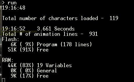

jman, that is really great! But it leaves me with one big question that has been bothering me... Why does it take so long to read the data using regular READ/DATA statements? It seem like that should be very fast compared to connecting to an external device and reading the values.
--Curtis
Posted: 06:49am 21 Sep 2015
Curtis,
I tried to change your code by just loading the arrays directly but ran into memory problems.
I think the data reading is not optimized. This is a known problem in other basics from the 80's. In some cases moving the data statements to the top increased the speed. Here however it did not make much difference.
One thing to notice is that it get increasingly slower when getting closer to the end.
This suggests that the data statements are not 'indexed' and searching for the next data to read takes longer and longer.
Might be good to report this to Geoff as data statements are often only used for little blocks of data and not as much as you need here.
There are several optimizations you could try but those make reading the data a bit more difficult. You could however use the loop that reads the data to output code that you can copy and paste into your program replacing the data.
For instance leaving out all the leading zeros will save a lot of storage space.
For the animation data you could combine the first 8 values into a 8 character long string. This would increase the reading of the data almost 8 times as well.
So instead of Eyes(xxx,9) you use Eyes(xxx) as string * 8 and EyesDuration(xxx)
