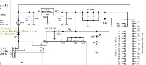

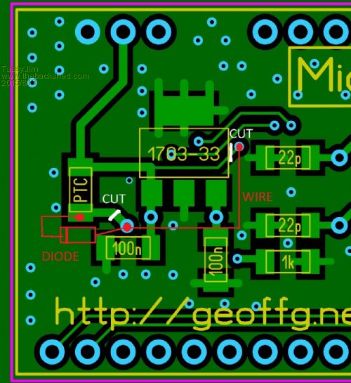

Hi TassyJim,
can you please paint a lite schematic for this workaround?
It is difficult for a not native english speaker to understand this...
THX
  TassyJim said
I have my explore64 wired as per the V3 circuit. Diode isolating the USB power and the Vbus routed to the USB side of the diode.
Posted: 12:57pm 13 Aug 2015
  atmega8 said   Hi TassyJim,
THX
I also added a diode in my external 5V to stop the USB from trying to supply the external circuit.

ahh, ok i understand...but where do you feed in the external power?
Will try this...
But very is the (causal) problem located?
Does Geoff have to fix the usb implementation in mm+ or ist there an incompatibility in the MS WIN 10 USB Implementation ? Edited by atmega8 2015-08-14

@TassyJim:
That's exact the same solution that I am found!
...but I will use a SMD diode as triangle with the PTC - than it is not necessary to cut the track below the PTC.
@atmega8:
You can feed in the external power on the "5v0_OUT" Pin. The voltage is blocked by the diode and goes directly to the regulator...
Frank
