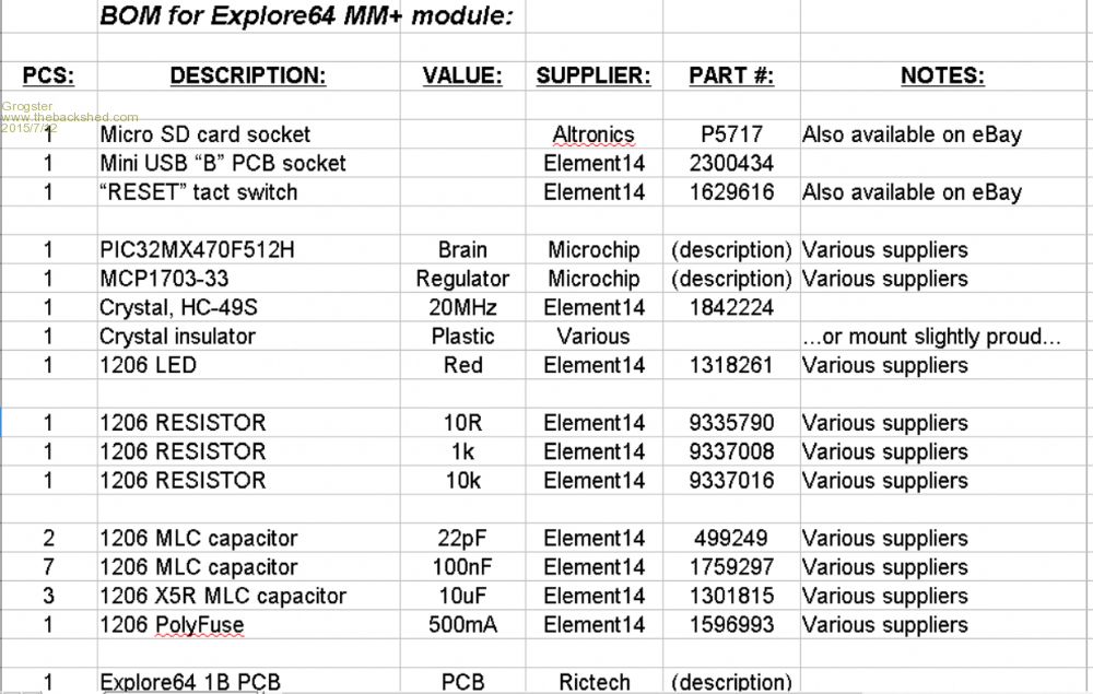

Here is the BOM for those of you ordering boards, so you can get in the bits you need to assemble the unit.
I will also be uploading a link to a full ZIP file that contains this BOM as well as overlay diagrams and a schematic soon.
Watch this space....(thread!)

Thanks for the BOM, and I've ordered all my parts... but how about a text document version for future boards. It would be nice to be able to cut and paste part numbers or descriptions directly into Element14/Mouser/Altronics etc.
--Curtis
Posts: 10114
Posted: 02:46pm 13 Jul 2015
@ Jim - I am about to launch my website(by end of July), and it will then host the documents, but thanks very much for the offer.
@ Curtis - Good point. I will include an ODS and XLS file versions of the BOM from now on for anything so you can copy-and-paste as you say - good idea.

Here's a BOM with Mouser, Newark and Element14 part numbers. Newark and Element 14 are the same place, so maybe the Newark numbers are US?
A few parts in Newark's catalog are only stocked in the UK. Could be right now or indefinitely. Dunno.
Not all Mouser parts are the same vendor as Newark but they are equivalent. The only other special part is the Hirose mini USB B socket: it's available at both Newark and Mouser.
I couldn't find the same SD socket at Mouser but I did find it on eBay.
Micro SD card socket Altronics P5717
Mini USB B socket, short (Hirose UX60SC-MB-5ST(80)) Mouser 798-UX60SCMB5ST01 Newark 69W0710 Element14 2300434 [UK only for Newark]
Reset switch (E-switch TL3302BF180QG) Mouser 612-TL3302BF180QG (or 506-FSMSM) Newark 15N4506 Element14 1629616
PIC32MX470F512H Mouser 579-32MX470F512HIPT Newark 49X0835 [UK only for Newark]
MCP1703-33 Mouser 579-MCP1703-3302E/DB Newark 09P3988 [UK only for Newark]
Crystal 20mhz HC-49S Mouser 717-9B-20.000MAAJ-B Newark 84R5813 Element14 1842224
Crystal insulator
KINGBRIGHT LED, RED, 1.6MM X 2MM, 230MCD, 630NM 1206 (KPC-3216SURCK) Mouser 710-150120RS75000 Newark 31M5204 Element14 1318261
10 ohm resistor 1206 Mouser 660-RK73H2BTTD10R0F Newark 94W6473 Element14 9335790
1k ohm resistor 1206 Mouser 660-RK73H2BTTD1001F Newark 39K0993 Element14 9337008 [UK only for Newark]
10k ohm resistor 1206 Mouser 660-RK73H2BTTD1002F Newark 39K0994 Element14 9337016 [UK only for Newark]
22pf MLCC cap 1206 Mouser 77-VJ1206A220KXACBC Newark 96K4783 Element14 499249
0.1uf/100nf MLCC cap 1206 Mouser 77-VJ1206Y104KXQPBC Newark 90W2887 Element14 1759297
10uf X5R MLCC cap 1206 Mouser 77-VJ1206G106KXYTBC Newark 84K8407 Element14 1301815
Littlefuse 6v 500ma PTC Reset 1206 (1206L050YR) Mouser 576-1206L050YR Newark 53M6118 Element14 1596993
