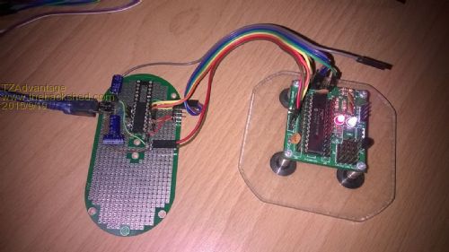

Here it is connected with Mick's MUP. Now your PIC32 chips can be programmed through USB without a bootloader.
As you can see power, serial and ICSP are all wired and no more need to take out these cables. When using MMEdit you can use the DTR to reset the uMite. The USBtoSerial will stay connected so you will not loose connection anymore when you have to reset.

Posted: 11:15am 19 Sep 2015
@Rob,
Would it be possible for you to pulse the DTR?
I think the best place is here:
[code]
// Serial port now open and configured.
//Pulse DTR (10ms is more than long enough)
//Pause for 50 milliseconds.
printf (" Adapter: ");
[/code]
Maybe for backward compatibility only use DTR when a -UseDTR is added to the command line. If it has no effect on the Nano then that would not be necessary.
And if i may ask. I would very much appreciate if you could add the ProductID.
I now use the same string as the Nano but that does not feel right.
The ProductID is "MicroBlocks - U2SPxxx"
The code stands for
U - USB
2 - to
S - Serial
P - Programmer
the 'xxx' are for future additions, in use now is U2SP5a. I am working on a U2SPH5a.
The 'H' stands for HID and the '5' for 500ma version. The 5 could also be replaced by a 1 (125ma) or a 2(250ma) depending on which voltage regulator is needed.
The last 'a' is the version.
As long as it starts with 'U2SP' it will have the ascii ICSP function available.

Chris Roper
Joined: 19/05/2015
Location: South Africa
Posts: 280
Posted: 11:58am 19 Sep 2015
This is great ZTA, well done and a big thank you
If I may ask a couple of questions or suggestions:
Are you allocating the same or different pins for PGC/PGD and Tx/Rx ?
I ask because it would be nice if both the ICSP and the Serial Connections could be permanently connected. If they were then the PGC/PGD lines could be made High Impedance after programming to free up the target device pins.
Secondly Have you, or would you be able to, add an LED or two to indicate traffic?
An LED to indicate Tx and Rx could do dual duty and Indicate programming in progress and a pass/fail indication.
I will Flash a 16F1455 with your code and start playing with it tomorrow, (after the F1 Race ).
Do you have a HEX file available, it would save some time ?
If not I will finaly have to cave in to Microchip, jump through the hoops and install MPLABX it will be worth it now that I have a valid reason though, and I would probably need it for CFunctions too, so not a waist of effort I guess.
Chris

I still have to figure out how the IO pins are implemented in hardware inside the PIC. As using the pins as outputs has the risk of having two outputs, one on the programmer side and one on the target being opposite values creating basically a 'short'.
This will be of extreme short duration but still it is not the proper way to do it.
As this is now specific for programming a PIC32 i have to look at both chips datasheet and see at what time the target PIC changes it PGD to an output.
If i can time it that right before that happens i can change it on the programmer side to an input it would be save.
