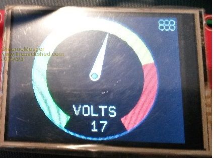

Thought I would combine Peters great work and use the 6 gauge screen as the main screen and when one gauge is tapped the LCD shows only that gauge for closer inspection with an icon on the top right to return to the 6 gauge screen.

  Quote  Now all you need is Mick's suggestion of flashing the background red when a gauge goes into the red.
I will look into it, even giving the icon coloured in circles representing the state of the 6 gauges.

  Graeme Meager said   Thought I would combine Peters great work and use the 6 gauge screen as the main screen and when one gauge is tapped the LCD shows only that gauge for closer inspection with an icon on the top right to return to the 6 gauge screen.
GM
Or a Home Icon?
Lower right, a Menu Icon for additional system, or individual gauge settings?

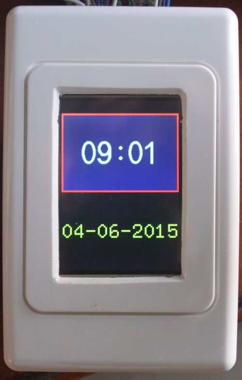

Posted: 01:14pm 03 Jun 2015
All I need now is a decent way of mounting them.
The BOSS has conceded to having one on the wall for a weather station display.
My effort so far with a 2.4" display:
It is a 'Delta' brand light switch/blanking plate (from Bunnings) with the innards cut out.
I made the hole a bit too big but it allows fat fingers to 'touch'.
The standard mounting holes had to go but there are plenty of other mounting holes to use.
It might look a bit strange on the dash of a plane/boat/car but the BOSS is happy so I am happy.

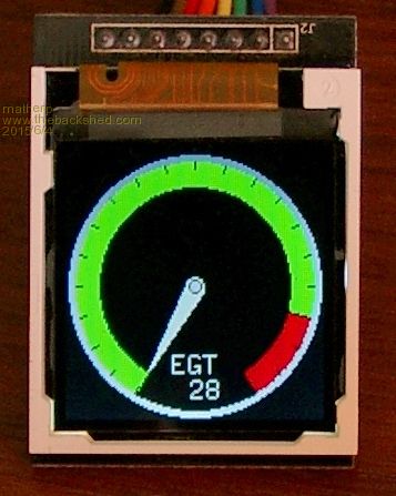

Posted: 12:59am 04 Jun 2015
Here is an additional feature, the ability to put small scale marks on the display
Call for the above was:
initgauge(0,mm.hres\2,mm.vres\2,mm.hres\2-5,1,-150,-150,105,105,150,"EGT",15)
where the final 15 is optional but specifies putting marks at 15 degree intervals. The revised routines are given below.
Also attached as a zip file is a fully implemented EGT program ready to go into the aircraft
2015-06-04_111036_egt.zip
