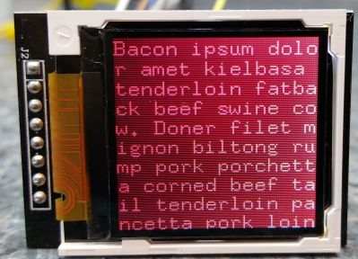

Tested on 1.44" ILI9163 display:

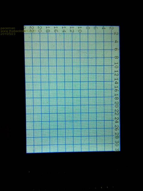

My question is, is there a simple means of determining where something is going to live on the screen, I have thought of a sheet of graph paper or just suck it and see as I have been doing.
Cliff
Cliff
paceman
Joined: 07/10/2011
Posts: 1329
Posted: 08:39pm 22 May 2015
Something like this Cliff? BTW that's the 2.4" screen, not graph paper
OPTION EXPLICIT
DIM INTEGER i
CLS rgb(white)
FOR i=0 TO 240 STEP 20
LINE 0,i,320,i,,rgb(blue)
text 2,i,STR$(i/10),m,,,rgb(black),rgb(white)
NEXT
FOR i=0 TO 320 STEP 20
LINE i,0,i,240,,rgb(blue)
text i,2,STR$(i/10),c,,,rgb(black),rgb(white)
NEXT
Edited by paceman 2015-05-24

paceman
Thanks for the graph paper works ok had to change it a bit as I am using PORTRAIT mode.

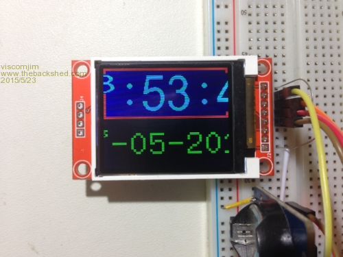

I am having an issue with the 1.8" ST7735 display. I am running beta 3.
OPTION LCDPANEL ST7735, L, 2, 4
OPTION EXPLICIT
CONST DBLUE = RGB(0,0,128)
COLOUR RGB(GREEN), RGB(BLACK)
FONT 1, 3
BOX 0, 0, MM.HRES-1, MM.VRES/2, 3, RGB(RED), DBLUE
RTC GETTIME
DO
TEXT MM.HRES/2, MM.VRES/4, TIME$, CM, 2, 1, RGB(CYAN), DBLUE
TEXT MM.HRES/2, MM.VRES*3/4, DATE$, CM
LOOP
'X = MM.HRES
'Y = MM.VRES
'PRINT X,Y
My display draws the box correctly but the text is very large as shown...
when I do the mm.hres and mm.vres it shows 160 x 128
EDIT...
I guess I should play with the font command and report back. DUH!
EDIT 2...

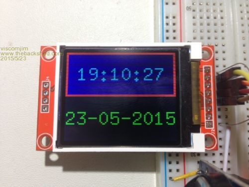

Yep! RTFM Jim. Here is new code for smaller display...
OPTION EXPLICIT
FONT 1, 2
RTC GETTIME
DO
TEXT MM.HRES/2, MM.VRES/4, TIME$, CM, 1, 2, RGB(CYAN), DBLUE
LOOP
'X = MM.HRES
'Y = MM.VRES
'PRINT X,Y
and result...

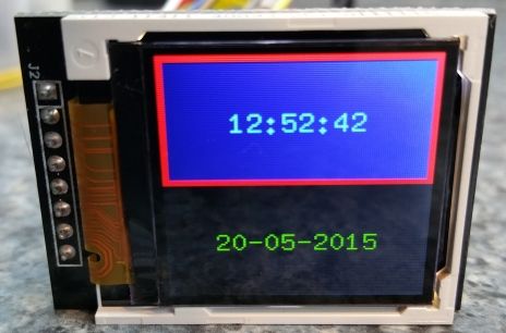

CircuitGizmos
Joined: 08/09/2011
Posts: 1427
Posted: 01:25pm 23 May 2015
I had to do the same for the 1.44" display.
