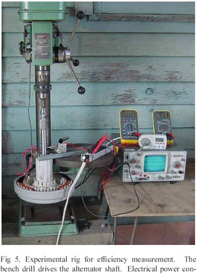

I see the CRO output voltage waveform on the last pic and Digital RMS meters. Not a bad sine wave, not real good to try and put into a battery though. The only time current can flow is when mill volts > batt volts. If you are measuring RMS V and A then you are seriously under-estimating the real peak V & A. I can not begin to predict the outcome with cheaper metering.
I also notice the use of a SparOmeter power meter. I have one of these. They under or over estimate depending on the power factor of the load.
Has anyone looked at the current waveform with a CRO for a Cap v non Cap system into a battery.
a bit of digression here---
The sine wave output problem is why I designed my mill gen to produce a close square wave output. I recall that early Southern Cross gen sets also produced a square wave output specific for charging a battery. Sine waves are produced by utilities primarily as they are easy to transform and introduce low harmonic content.
Do the capacitors change the shape of the voltage waveform of the mill into a resistive load? If the sine waveform is flattened on the top and bottom then battery charging will be improved, as peak currents will be reduced, closer to the average.

HI All I would suggest the picture of Glens F and P in a drill press has not got caps on it. Therefore get a 80s F and P , do the standard rewire 80sp put the caps on exactly as shown and then criticize.

Hi Dennis,
to be fair on Gizmo, the photo was lifted from a research paper and is not his mill. The gen is another mod of a F&P, 100S with half of the stator fingers removed. This leaves 3 phases with 7 coils in series.

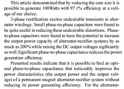

My reading of the article would suggest that the 3.3uF caps across each phase and the 713rpm would equate to a cap > 100uF for an 80SP operating at half the rpm.
The paper clearly concludes that power output can be expected to increase by as much as 200% with caps, but at the expense of generator efficiency.
My conclusion is similar to gizmo, that caps change the characteristics of a mill, similar to rewiring, but simpler, but at the expense of causing a higher current to flow. The power densitity of the mill increases at the same rpm, but at the expense of a lower generator efficiency, as was stated in the article.
The addition of caps will enable the mill to put out power earlier, but this will mean that the blade optimum operating relative wind angle will now change, as the mill will load more at the same rpm.
were the rpm v amps quoted above from a mill in the wind or bench testing with a lathe etc? If the testing was on the bench, then a few more data sets would be useful, particularly in the 150-250rpm range.
a preliminary plot shows very rapid loading with rpm. I can only assume that these are bench test data. An under driven mill would probably go into stall attempting to produce a higher output.
After adding caps, blade retuning may be required.

Posted: 07:11am 23 Oct 2007
Hi FandPwithPVC,
here is the section from the conclusions on the last page of Dr Chalko's paper.
This was the confirmation of your experimental results from another source.
cheers, Gordon.
