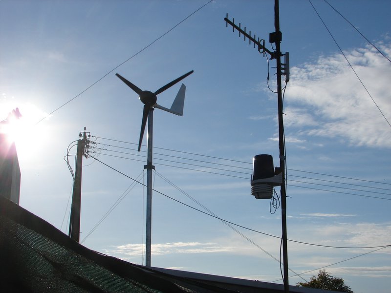

I have answered my own question, re images.
I have just included a pic of my mill. Not too much happening on this day.

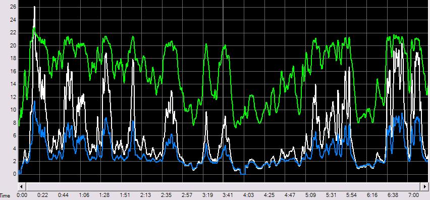

the next photo is output from the mill. voltage and amps with power included. 10 readings per second recording. about 7 mins in total.
This is a typical average day output at my site
Amps in blue, volts in green and power/10 in white.
This is how my MPPT loads my mill.
You will notice how the voltage and current vary with time. The mill rpm follows the windspeed. The electronics responds very rapidly to the changing power, increasing or decreasing. I have compared the windspeed log from my weather station and the gusts follow a linear up and down in windspeed, while the power output follows the cubic relationship. This is what you would expect from a true MPPT.
The F&P mill with MPPT will respond slightly differently to my mill with a MPPT.
Warpspeed uses the feed forward expression. I would call the control process I use as direct control. The generator voltage directly controls the loading of my mill using a variable current limiting process. There is no feedback control, negative, or positive. The sensing element is the voltage controlled shunt in the battery negative. No hall effects used, and all DC coupled to the modulator summing junction.
This approach was my electronic conclusion to a voltage controlled relay arrangement that bank switched my 4 rectified and filtered phases out from 4s to 2s x 2p to 4p as the windspeed increased. the click clack of relays up on the tower was frustrating and power wasting, with no semiconductor option.
I hope the discussion continues, so that the MPPT with F&P can be concluded.
cheers, Gordon.
