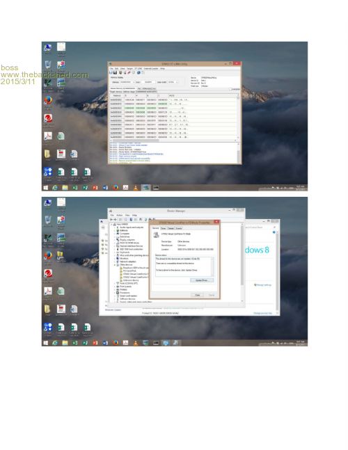

boss
Joined: 19/08/2011
Posts: 268
Posted: 07:09am 11 Mar 2015
ST-link works like charm now on the same comp with virgin 8.1 installation.
Problems persist with virtual driver.
Bo
boss
Joined: 19/08/2011
Posts: 268
Posted: 11:27am 11 Mar 2015
Works fine now on W 8.1 FW b12.
Bo

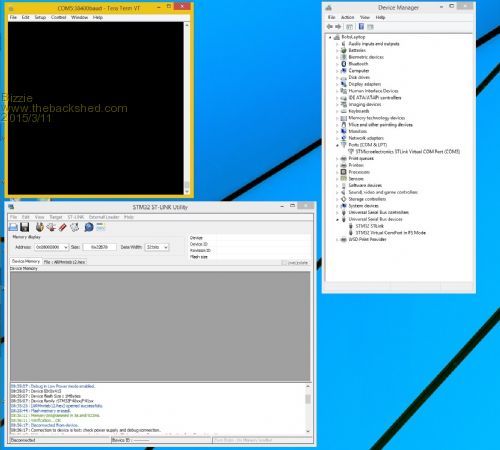

Bizzie
Joined: 06/07/2014
Posts: 194
Posted: 11:57am 11 Mar 2015
Just tried B12 exactly same sysptoms:-
All looks OK but no message on TT (com5) see below
A couple observations:-
The erase seems to work now. Tried the boot0 to VDD link and then an erase.
A reset of the STM32 shows com5 being disconnected and reconnected.
A compare of the hex file and STM32 flash memory are identical.
The cable used seems OK - Used to connect my phone to my PC and reset shows the connection.
Rob White
dmasz
Joined: 12/09/2013
Location: Poland
Posts: 21
Posted: 12:39pm 11 Mar 2015
hello hello :)
i managed to install STM VCP drivers on windows 8.1 64bit
and after installation i am able to connect from teraterm via microusb to ARMite (firmware b12).
my procedure:
1) install
VCP_V1.4.0_Setup.exe
2) then follow this tutorial.
install unsigned driver by switching off driver signature checking:
http://revryl.com/2013/08/06/install-unsigned-drivers/
3) time to run driver installation.
C:\Program Files (x86)\STMicroelectronics\Software\Virtual comport driver\Win8\dpinst_amd64.exe
after this steps i was able to see in device manager
>STMicroelectronics Virtual COM Port as com3
4) restart discovery board by power cycling it.
and now connection is working fine
hope it will help to others

boss
Joined: 19/08/2011
Posts: 268
Posted: 01:36pm 11 Mar 2015
@Grogster
Installation ST-link and ST virtual port with fresh installed W8.1 pro as admin works OOB. Well I spent almost 2 days with trying and testing. Fresh W 8.1 installation solved my problem.
Bo

Bizzie
Joined: 06/07/2014
Posts: 194
Posted: 10:55pm 11 Mar 2015
I have finally got the STM32 working over USB!
I followed dmasz's instructions but had to repeat the last step several times, not sure why.
I also used an account with admin privileges instead of giving the admin password, of course I do not know if this was essential or not.
I will now have a play with the beast.
Thanks you all for your input.
