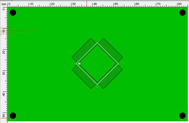

Conceptual drawing only, but I love a challenge, and you, Rob, have posted a worthy one! Edited by Grogster 2015-02-17

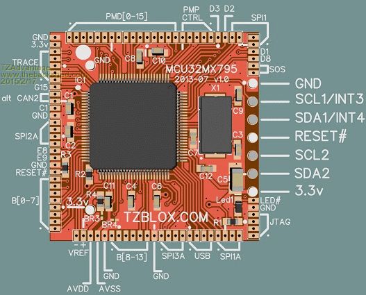

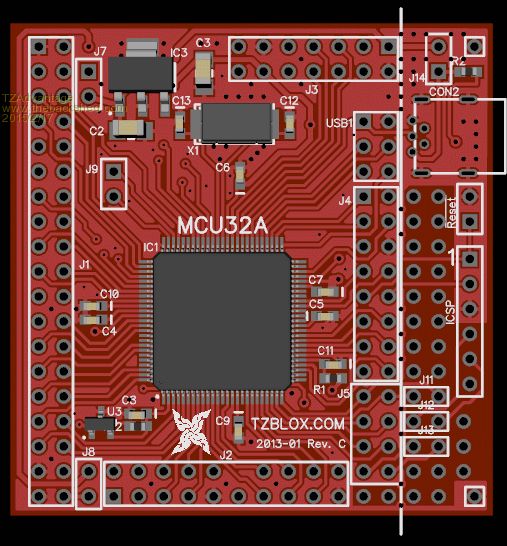

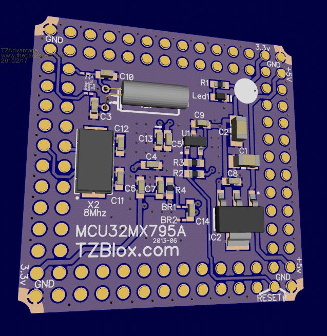

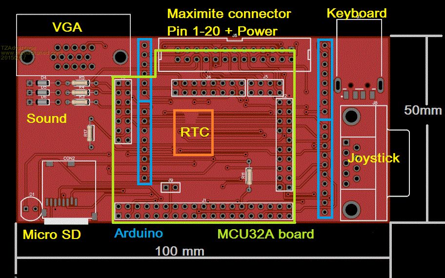

Posted: 08:07pm 16 Feb 2015
I already designed something like that 2 years ago.
The idea was to have the mpu on a separate plugin module so you would have just a processing module with all the stuff that is needed like caps and crystal.
Then all the connectors to make it into something specific, like a color maximite by using another board.
Like this:
That would be all through hole to make it easy for a hobbyist.
The mpu module would be all smd.
That 'module' evolved to:
and this:
Until a in my eyes a disastrous kickstarter (Color Maximite) changed my view together with the arrival of the uMite. Then the 150 was actually more interesting,until it changed into a MkII with the 170 and now again changing into a 470.
It is all getting better and better, but to build some parts that are a little bit more viable over the long term is the only way.
So wait some time to sit out this 'storm' of new things then settle for a model, then produce some quantities to get an interesting price.

Posted: 11:47pm 16 Feb 2015
tzadvantage: the problem with the MCU32A core board et al is that the design philosophy looks to blow out the us$20 budget. what do you reckon the production cost of a set of your boards would be? the MCU32MX795 looks like it may be a commercial product that you sell - what is the retail price?

grogster: can i perhaps talk you into chucking just the component outlines onto the layout? certainly no wiring at all. if your cad package could spit out a 3D model, that would be absolutely magic.
i still reckon (based upon just a little industry experience i have) that something could be put together that fits within the us$20 budget. all that is required is a little nous. if nobody else does, i'll look at fleshing out the BOM with some prices.

Posts: 10109
Posted: 01:07am 17 Feb 2015
Acknowledged - stay tuned to this frequency.
Seven after midnight here, so time for sleep. I will look into this tomorrow, and plop something up for you to look at.
