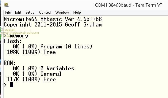

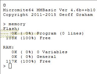

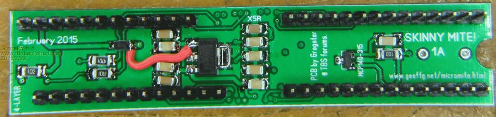

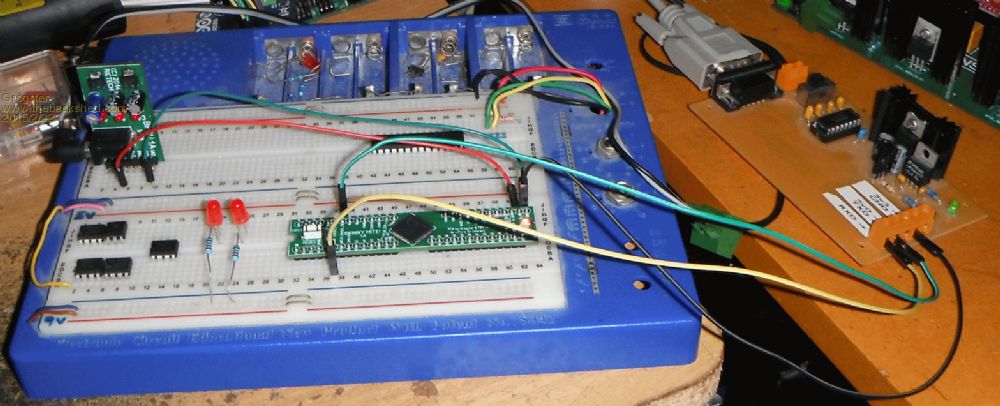

UPDATE: Everything seems to work OK on the prototype board:
If I can get it going OK, I am confident that others getting boards will also be able to.
NOW - on to some testing.........
EDIT: Basic testing(no pun intended!) at the default speed does not seem to show any issues, and I am now running the 470 @ 96MHz - again - there does not seem to be any issues that I can detect at the moment.Edited by Grogster 2015-02-23

You don't HAVE to use the reset(supervisory) chip, but I think it is a good idea.
It holds the 470 in a RESET state until the power supply is stable and will hold the chip in RESET if the supply brown-out's to 3.15 volts or less, allowing for a clean reset. Dirty power can be the cause of some odd things with these modern and powerful MCU's, and the supervisory chip only adds about $1 to the price. For one extra buck, it could save you a lot of stress with something as juicy as the 470 - it can hold A-LOT of program code!!!!

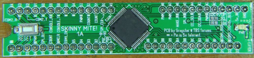

Well I have passed soldering 101 for SMD 1206.
The soldering was easier than expected, but probably only because I had got a few things ready for it as suggested. The Gel Flux, magnifying light, tiny pair of tweezers and a new tip for the soldering iron.
I initially put the power LED on the wrong way,but once swapped around it was OK.
The LED had two small green marks at one end,so I though this was the pointy end, ie the Cathode. There is a small dot on the silkscreen, I assumed this would be the Cathode. Is there a convention for the placement of the dot and does it mean Anode?
The supervisor MCP130-315 is sometimes referred to as MCP140-315 (BOM, silkscreen) but the part I got based on the part no. was MCP130-315 and schematic refers to MCP130-315.
A neat little board.
Thanks Grogster.
