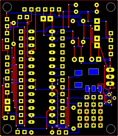

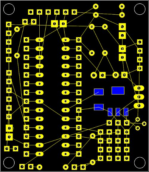

Just as an example of the internal router I have used my first effort of doing a PCB using AUTOTRAX DEX (ok 2nd as this is my Ver 2 MuP) I have removed the copper pours for clarity.
Here is the board unrouted and showing the nets loaded.
Here is how DEX routed the PCB

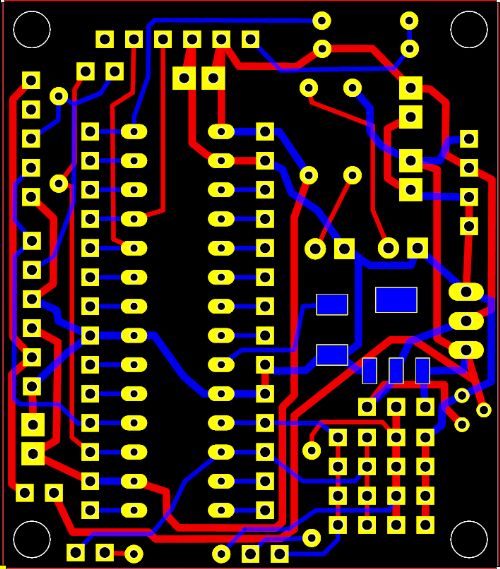

After maybe 2 hours of work I have cleared it up a fair bit and this is what I ended up with.. No vias at all.
I now try to make every track on a 45 or 90 degree angle and avoid 90 degree bends, but this was my earlier efforts.

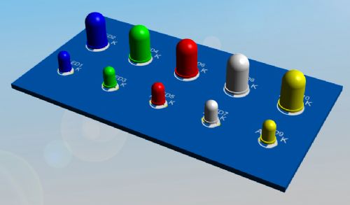

I have been reconsidering my thoughts on 3D and decided to create my parts with 3D models.

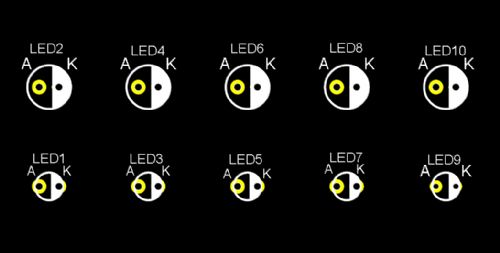

I have started with LEDs and have created (editted from existing parts to suit my requirements) these if anyone is interested.
2015-02-03_091452_LEDs.zip

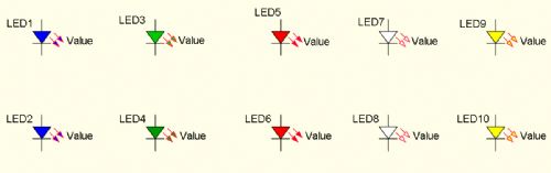

The following are examples of the LEDs,
5 colours (Blue Green Red White Yellow) and 3mm and 5mm packages
3D Examples
Overlay Examples
Schematic
ENJOY!!
EDIT***
If anyone knows how to put a flat on the cathode in the 3D drawing please let me know how and I will add them.

You can download images but aparrently these add a fair bit of size (Kb) to the parts... These ones are generated by three geometric parts , a sphere, tall cylinder and a short cylinder .
The images and schematic are on parts that are already in the library but I hated the overlays and the colour of the 3d was translucent which, albeit sort of like the real parts, I didn't like so I edited them. They were also for 3mm LEDs so I also editted them to create 5mm ones.. If there is interest I can also do 8mm and 10mm ones.

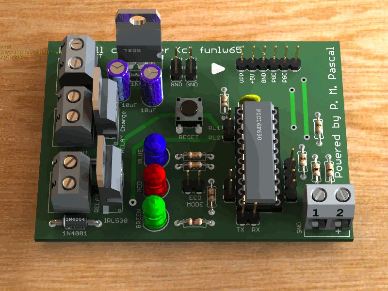

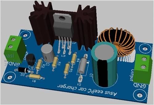

3D board in DipTrace with KiCAD 3D objects - the advantage of a common file format - maybe is the same for AutoTRAX, can someone check this?
And strictly artistic, IMO nothing beats Eagle+Eagle3D+POVray team regarding the rendering result:
The disadvantage is that it lacks the integration and is difficult to use it. And to be honest, is not an attribute of Eagle as is for AutoTRAX, KiCAD, DipTrace, etc.
Anyway, nice to have the 3D object of any components you use.

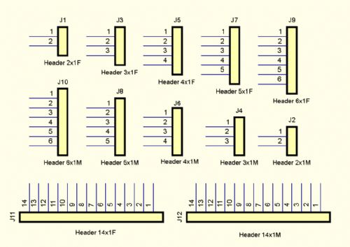

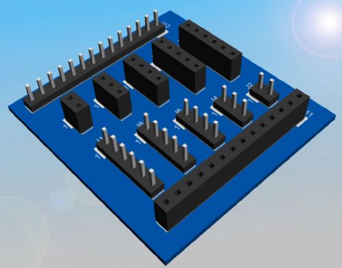

I have redone Some SIP headers for DEX to include 3D objects. As per usual these were done to suit my needs and preferences so they may not suit yours..
I have included in this pack 2pin, 3pin, 4pin, 5pin, 6pin and 14pin both Male and Female. I will add more as time permits and I will do dual row headers as well but at this stage it is only the headers that I use on my boards that I have redone.
2015-02-14_015033_Headers_SIP.zip
All of the Pin1's are actually a square pad (can't be seen under the white silkscreen) but of course you can change these on the fly if you don't want that.
