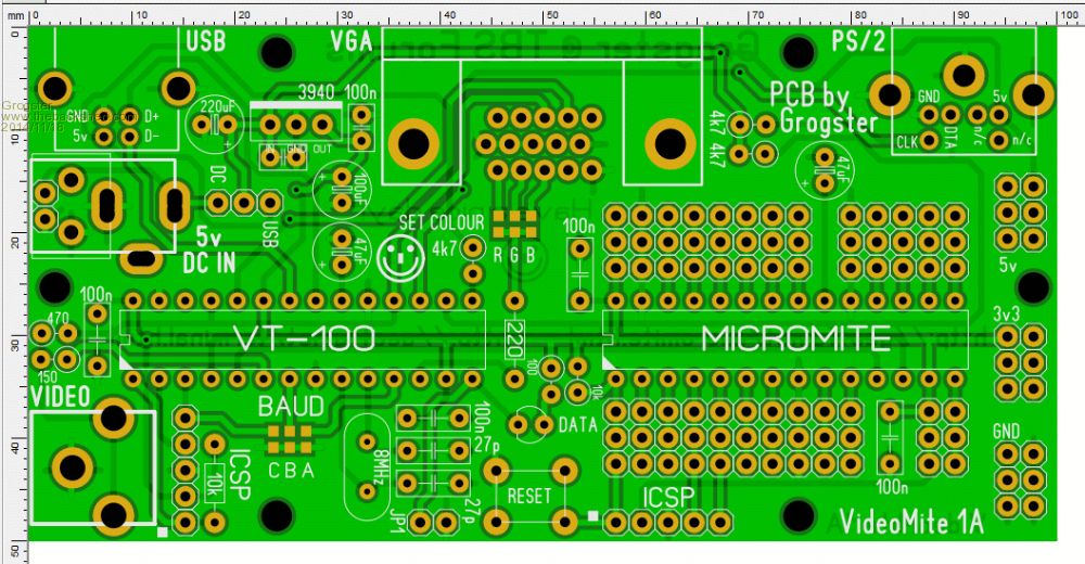

Hi Grogster,
Are those two links above the 5V DC IN text? If so, you need to label which one does the USB power which one is external power.
Posts: 10109
Posted: 12:52pm 18 Nov 2014
They were diodes, but I have changed them to a 3-way jumper link arrangement.
Annoyingly, you were right about the schotkky diodes' forward voltage-drop.
I was assured that Schottky diodes only have a 0.1v voltage-drop, but when I actually looked up the datasheet for the diodes I have been using, the forward voltage-drop is actually 0.45v.
That's still better then the 0.6v drop of 40xx diodes, but it is not the 0.1v I was told was the case with Schottky's.
So, the onus is on the user to make sure the polarity is correct with the 5v DC connection.Edited by Grogster 2014-11-19

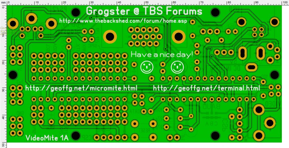

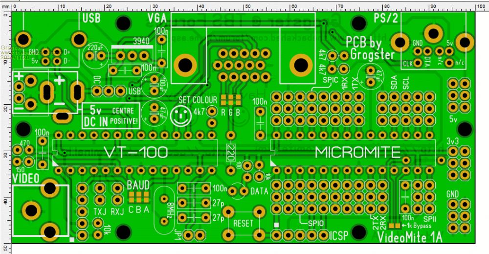

EDIT: Here we are then.....
Top side:
Bottom side:
Edited by Grogster 2014-11-20

Hey Grogs is that left hand smiley face on the `back side' ME?
Minor Criticisms.
If you can make the + and - a bit bigger font for power input it would be better.
If you can move the USB from the jumper up and maybe r/a (with a line pointing to the pin if needed) then the CENTRE POSITIVE message can be level with 5vDC IN and the entire message enclosed in the BOX.
PS.
Were you able to shave 0.5mm off the height to panelise for cost saving? Although on second thought that might not be necessary anyway 2 x 50mm boards with the vee groove down the centre would probably be ok anyway.. If you want me to create a border outline with cut outs gerber for you let me know.
PPS.
My second lot of boards arrived from Shenzhen today, the first lot took 14 days for postage, this lot took 16 days.. Not bad for the price compared to the expense they want for DHL.
Posts: 10109
Posted: 08:52pm 18 Nov 2014
  bigmik said   Hey Grogs is that left hand smiley face on the `back side' ME?
It can be you, if you want it to be.
  Mick said  If you can make the + and - a bit bigger font for power input it would be better.
Yep, I can do that - will post updated image soon.

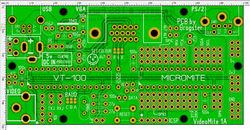

Here is the image with the changes you suggested:
EDIT: I have added two jumpers - TXJ and RXJ. With these jumpers in place, the uM is routed to the VT100. If you remove them, you can then use lower pins of those jumpers, and the GND from the adjacent ICSP, as a serial connection to the VT100 if you want to use it separate from the on-board Micromite in testing other hook-ups.
Likewise, you can remove these same jumpers, and then tap into the Micromite console, without the VT100 upsetting the mix by being permanently connected.
The normal arrangement, would be jumpers on these two points(and transfer code to the Micromite via the VT100's USB interface), but it gives you the flexibility to alter things depending on what you happen to be doing.

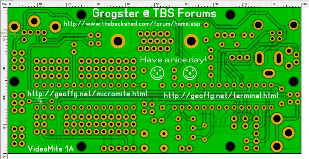

Posts: 10109
Posted: 01:38am 19 Nov 2014
What value is that? 10k?
In series with the uM RXD, correct?
EDIT: I have assumed this resistor is 10k, but it can be anything. I have it installed on the bottom copper layer. Standard resistor. In series with the uM RXD.Edited by Grogster 2014-11-20

Posted: 02:23am 19 Nov 2014
No, 1K not 10K. Yep, in series to uMite RX. It might save a few puzzled, disgruntled users in future!
Edited by paceman 2014-11-20
Posts: 10109
Posted: 02:28am 19 Nov 2014
OK, 1k. It shall be so labelled.
Is the 1k in series with the uM RXD still OK to be there for 3v3 operation?
I would prefer to be able to leave it there permanently...

Posted: 02:41am 19 Nov 2014
I use the 1K permanently in with a 3.3v adapter and it works fine. I just checked Mick's MUP V2 and he has a jumper to remove it you want to, when using a 3.3v one. I don't think you need to do that but it might be best to check with him.

I have found the same, that it still works at 3v3 with the resistor in but I suppose that there is no guarantee that all USB-TTL converters will work with the resistor there.
Posts: 10109
Posted: 08:23pm 19 Nov 2014
@ Greg & Mick - I will include the resistor by default, and add solder blob pads to allow you to short it out if you need to. That should cover both possibilities.

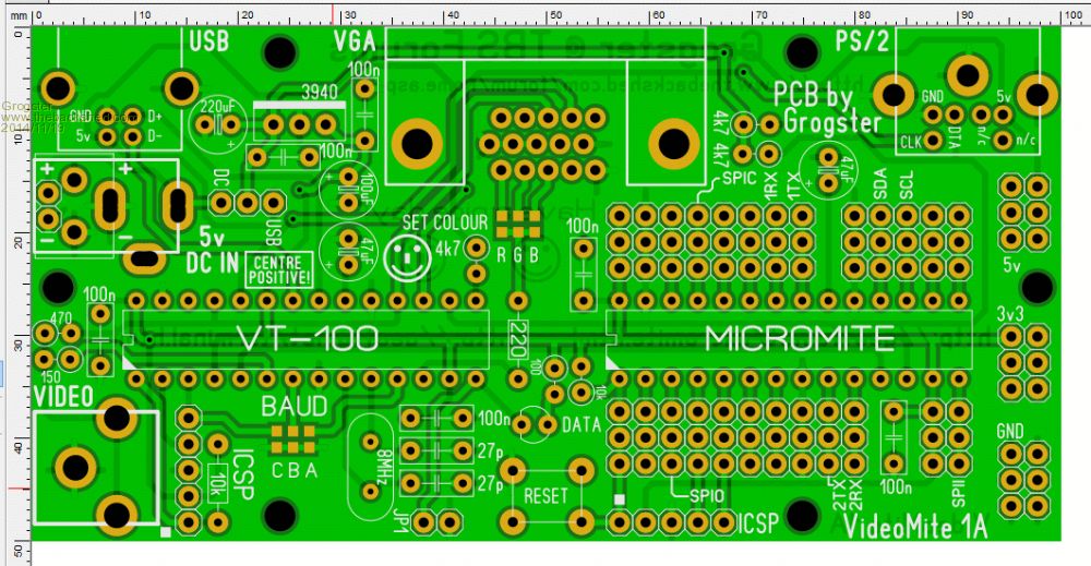

OK, here you are then. This is the board I will be ordering tomorrow.
TOP LAYER:
BOTTOM LAYER:
