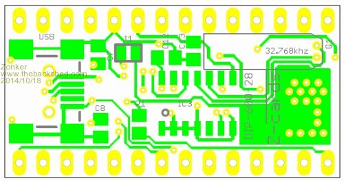

After creating the library part, it looks like a monster sitting next to the board and was a bad choice... I would like to keep the final size of the board to match the standard 28 pin DIP... Back to the drawing board... Where would you find the uber small one you mentioned..? There has to be something we can use... Will keep looking... Any help would be awesome... I am done for the day as the baseball game is starting up soon... Monday is around the corner, with the 10 hour days.. Yikes

As mentioned in a previous post, try this one maybe!
Posts: 2998
Posted: 02:18pm 12 Oct 2014
This switch is mounted on the edge - smallest one yet!
See here how it mounts (the one on the right) . . .

Thanks Phil..!
You are awesome man..! I love the edge mount design..
I will get started making the library part after work
Bang on it bro...

Got done adding the TL4100 Switch to the library... (digikey EG4963CT-ND)
Looks and fits good hanging off the left side of the board.. (excellent)
This switch is not going to effect the "heat spreader" area that much so we can keep most of it..! I will post an update as soon as I get done fussing with it...

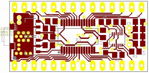

Well, after a few days delay, I think we got this one to the done state...
A bit more cleanup work that expected...
Will post the Gerbers after final checks...

Well, since the gerbers are untested, I figure on ordering 20 boards from I-tead and try hand building 10 of them up to see if they work ok... Lou and I will give a go at the soldering iron and see what happens... Assuming that goes ok, we should have a set of completed units and a set of flats to pass around for others to evaluate...
Attached are the Gerber files in I-tead and Eagle format names...
2014-10-18_222316_DIP-600-28_Itead_Gerbers.zip
2014-10-18_222345_DIP-600-28_Standard_Gerbers.zip
I looked these file over using this Online Gerber Viewer to check the output... they seem ok to me but have a look to see if I missed anything...

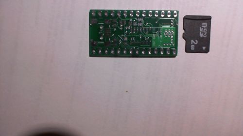

Well, FINALLY, The new boards have arrived...
Quality looks good... Now to glue some VERY small parts on..!!
Will keep everyone posted on the build process...

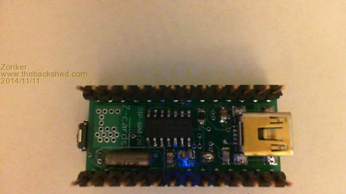

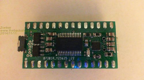

OK.. Just got the first one built, programed and working..! (sweet)
And the back side view...
Next is to get the RTC and Fram IC talking...
