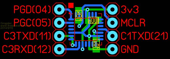

Looking at the datasheet, page 305, there IS a metal pad on the bottom of these chips.
Does it really matter if it is not connected to ground?
There are three other ground pins on the chip itself.....
Here is what I have so far:
This is still 1.5x DIL footprint(10mm). The numbers in brackets represent the pin numbers from the standard 28-pin DIL package that I have used.Edited by Grogster 2014-09-17

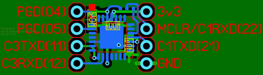

Here is my latest effort - all vias removed from under the chip where the pad is.
This layout also allow re-use of MCLR pin - it becomes the COM1 RXD when you solder-blob across the pads at the top of the module.
You just need to move the solder-blob, if you ever need to update the firmware.Edited by Grogster 2014-09-17

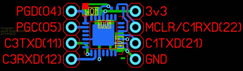

@ Mick - Page 5 of manual, very bottom:
  Quote  The metal plane on the bottom of the device is not connected to any pins and is recommended to be connected to Vss externally.
I am therefore using this plane, as a ground connection for the ground requirements of the chip itself.
Posts: 10108
Posted: 09:34pm 15 Sep 2014
Another update.
Now with ground-plane on copper2, linked to the ground-plane on copper1, which is then connected to all the chip ground points. Moved 10k pull-up resistor.

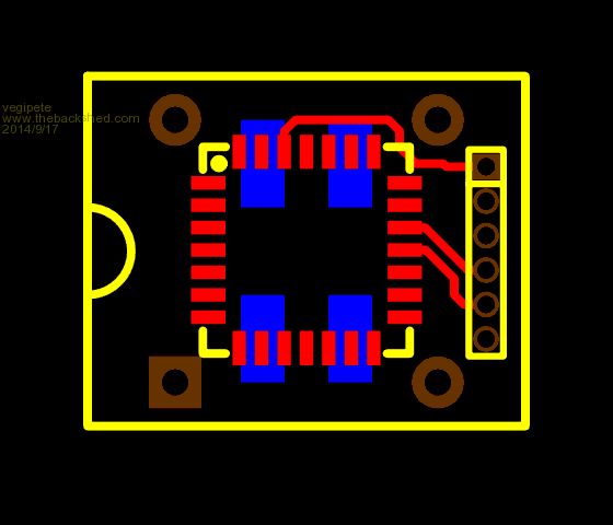

I've looked at putting physically tiny chips onto DIP like PCB's in the past too. It becomes clear that standard DIP sizes have real practical benefits. 40 pin .600 wide ones are easy. But this 8 pin DIP concept is interesting. An idea I had in the past was to use 'semi-depinned fine pitch headers' (if I may create some silly techno-babble.)
I've attached an image of a quick 8 pin DIP layout. The trick is to use something like a 7 pin .050" header for each side. With pins 2,4 and 6 pulled out, it becomes the correct 4 pin header. The pins are a smaller size than the .025 square pins on standard headers which suits plugging into sockets better. The other detail is the 4 center pins. As mentioned before, surface mount pins won't be overly robust. So I suggest that the 4 corner pins can be through hole, the 4 inner pins can be bent over and soldered surface mount style. As drawn, the 4 blue pads are for pins bent inwards, but outwards could work too if needed.
As much as possible, the 8 pin PCB should match the pinouts of, say, a PIC12F675. I'm not sure that the main pins need to include the ICSP/Debug pins - I've roughly drawn them connecting to a typical header, except with 1mm pitch (although PGD & PGC are likely reversed.) This would allow the device to be debugged in-circuit without consuming limited pins. An side benefit is that the USB D+/- pins of an 'MX2xx are automatically available on that same header for a possible USB port.
Food for thought...
Of course, if you are reflowing anyways, those 36 pin VTLAs are even smaller.

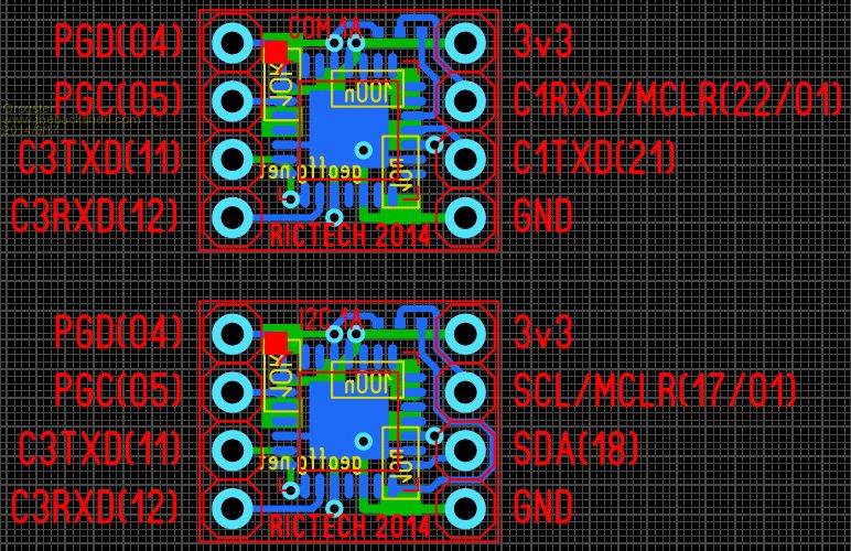

Currently, I have two versions I am getting prototyped, cos I already have a PCB waiting to get made, but was going to be bigger then 50x50, so have to use the 100x50 iTead service, so I might as well add these little boards to the panel, so I get some of them to play with at the same time.
The one labelled "COM 1A" is for serial port use, and "I2C 1A" is for I2C use. I am one pin short on the 8-pin idea, to be able to make an SPI one, due to the extra SPI line.
Both these boards are 13mm x 10mm(1.5x DIL) in size.
