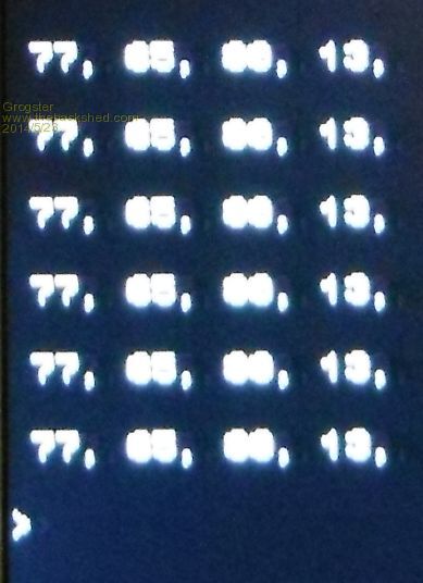

@ JohnS - thanks for the encouragement. We will solve it one way or another, sooner or later - I don't like unsolved mysteries.
@ Jim - I have connected the PICAXE to the MM, and that works fine(the MM responds fine via it's serial port buffer), and I was planning to setup a 8-pin PICAXE with SERIN and send something from the MM to it, so I will let you know about this in due course.
Once I have the 8-pin PICAXE in place, I can then connect the PICAXE and MM together as you suggest Jim, and can see what happens when I trip them both at the same time, with the serial message generator(based on the PICAXE 14M2).
In this image, the first three lines are the output from the 1st MM to the 2nd MM.
The last three lines are the output from the PICAXE to the MM.
Sorry the image is a little fuzzy - all lines are the same and read: 77, 65, 80, 13,
In other words: "map<cr>"

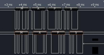

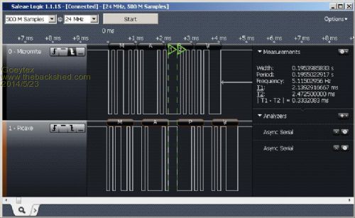

It seems you have the extra LF thing sorted out. Here are some thoughts.
A Picaxe 14M2 using software "serout" actually formats the data with three stop bits instead of one. This means that there is an extra ~208 microseconds between data bytes.
There is no significant difference in bit rate between the Picaxe and the Micromite. Both are very close to 9600. Picaxe 9594. Micromite 9640.
I set up the the breadboard with a Picaxe 14M2 and with a Micromite and then sent "MAP"<CR> with each.
Here is a screen shot showing the difference between the two as reported by Saleae Logic. You can clearly see the extra stop bits with the Picaxe.
Note: I used a Maximite with MMBasic V4.5D.
The Logic Analyzer is a clone from EBAY for ~$12.00. I cannot imagine troubleshooting serial data problems without one.
You might try: OPEN "COM1:9600,S2" as #1
This will ad an extra stop bit.
Blow is a screen shot with Micromite on top using 2 stop bits (S2) and Picaxe below with its built in 3 stop bits.
Edited by Goeytex 2014-05-24

SUCCESS!!!
If I use the S2 option, the pager transmitter is happy as Larry, and everything is working, and I was able to send a test page, just by using the MM command-line.
Goeytex - I owe you a HUGE beer or whiskey or vodka or whatever you drink. That was an excellent idea, and one I had never thought of, but obviously was where the problems was. Thanks to everyone who also added their suggestions and thoughts.
