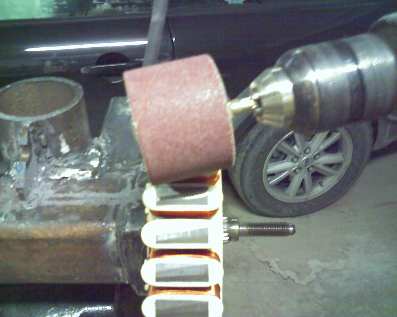

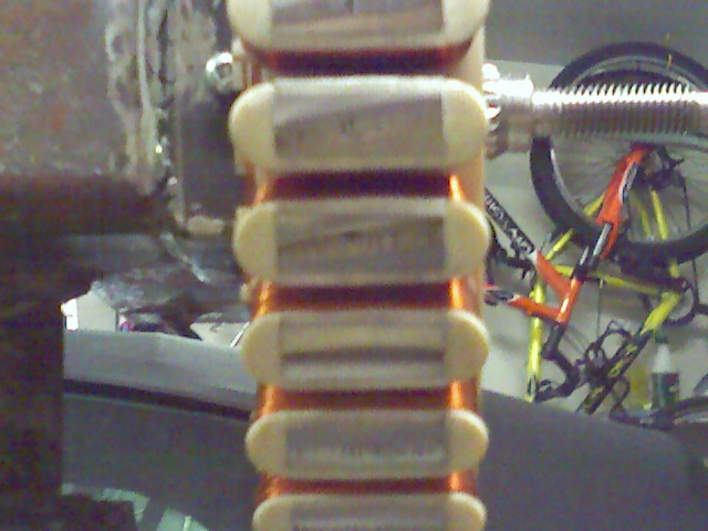

I was in the middle of decogging my F&P and remembered this thread. About half way through, I started sanding down the edges of the poles on an angle thinking that it might accomplish the same thing as twisting the poles. Anyway the results are very good, the cogging is only a small fraction of when I started. I only wish I could compare a stator decogged on an angle (on all the poles) to one done normally.
Sorry about the picture quality, I should have used something better than a cel phone camera.

Should be the way to go then John as that looks really easy and maybe more gentle than an angle grinder.

Thats very clever John. I did try grinding poles at an angle once but the powerfile I was using didn't work very well so I gave up, didn't think of using a rotary sander thingy. Using the rotary sander you have would make it a lot easier. Let us know how you think it all went once the mill is finished.
I should put a web page together on decogging the poles. How big was the sanding drum, and how many did you need to finish the job.

Posted: 01:31am 03 Feb 2008
It took some experimenting, I started with a narrow sander (like the one in the pictures) I bought just for the job, but I settled with the old drum sander with a 2 inch or 5 cm diameter drum. The metal must be very soft because it was an used 80 grit paper roll that I used worked well for the entire stator. Like I said I did not think of turning it on an angle until I was half done so I have half straight and half on an angle. It is difficult to hold the sander on the angle to get it started though, the sander wants to jump over the pole in the direction of rotation, so you have to hold it tight and watch where its grinding.

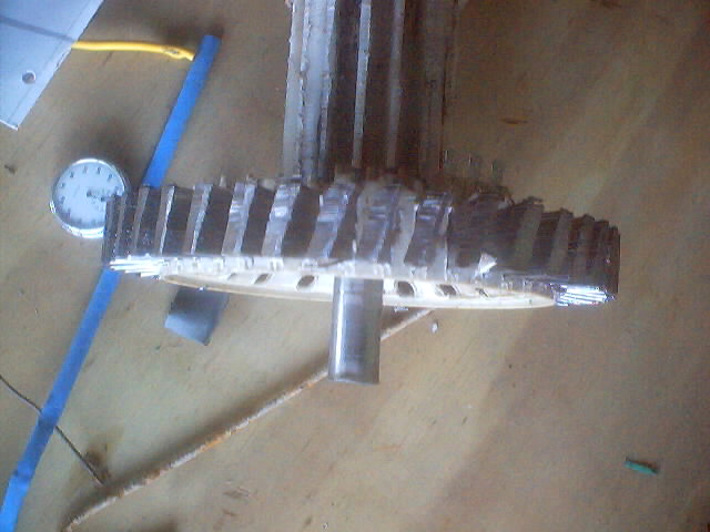

I just finished wiring the stator with your single 5 pole and triple 3 pole conefiguration you came up with. I separated the 5 pole in between the 3-3 pole sections of the stator to give the stator a more balanced load. Of course its not perfectly balanced, two 2 pole 3 phase sections for the 5 pole Y are separated in between 3 pole 3 phase sections leaving one 3 phase section roughly 120 degrees around the stator from the other sections of the 5 pole Y connection. It required more soldering, and I don't know if it would make any difference.
KiwiJohn noticed my poor welding skills, I'm sure I'll get better. I just took up welding for this project, I no longer have my professional welder freind to rely on. Anyway its worth a laugh.

Sorry John, I dont think that is poor welding at all, in fact I think it is just a little better than mine!

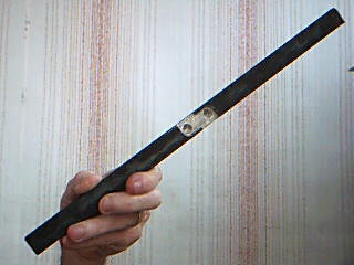

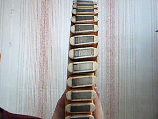

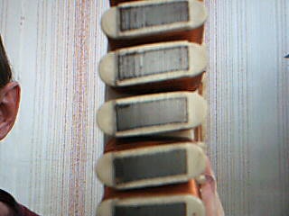

Hi,very new here and to this type of web site.I took on the idea of twisting the poles.To make them more uniform I made a tool which locates fairly accuratly over the end of each pole and in 2 mins all poles are twisted approx 10 deg.Then a light file or cut on the lathe to remove the high spots that occur at the 2 outermost corners of poles and no more heavy cogging.

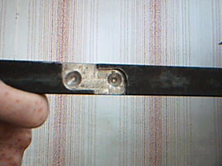

Hello,thanks for you interest.All it needs is a light cut on the lathe to finnish a uniform looking modification.The shape of the tool allows maximum clearance, purchase and control of twisting action.I hope this posting works as well?????????.

Great idea,,I'm a bit dumb ,,could you explain in more detail how that tool works and how do I make one,,dimensions,,what are the screws for ,bla bla,,much appreciate that

Hello Glenn,I am in the process of configuring a VAWT to use 2 F&P units believing that if I configure them correctly electrically that I can utilise the the high tourque and low revs to better advantage.I found twisting with windings to be no problem,just a slight creaking sound of windings relaxing into new position.I have considered purchasing ecoinnovation's manual but don't know if it's going to cover this option.Mechanically endowed but electrically on slow charge.

Hi Bruce,the tool is made from a piece of black bar 20x10x400 long.The stator poles plastic moulding is 40mm across from the top of the radius to radius and 14 mm wide.So mark two centres 40mm minus radius 7x2 14mm =26 along centreline and drill two 14mm holes to about 4mm deep.Then mill out the area between the holes leaving the edge intact.In other words we now have a slot 14 wide and 4 deep and 26 long to the centres.If you have a slot drill just mill the slot.This will give maximum purchase to the plastic moulding of pole.You then need to open the edge on opposite ends to allow maximum rotation of tool before it impinges on the adjacent poles.After twisting the poles on first rotation a second twist would also be possible but probably unnecessary.The screws are non existant they are where my 14mm drill point bottomed out.I didnt have a 14mm slot drill so I cleaned out slot with 12 mm end mill.

Great Anthony,, that explains the jig real good..
I'll mill out a slot in some stock and get back to you ,,if this can be done then it opens up a whole new area of experimentation---just what we need<hahaha..
