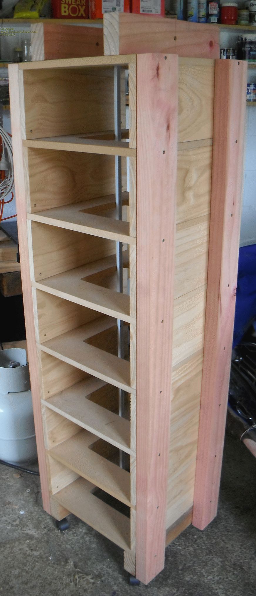

Posts: 10109
Posted: 06:35pm 04 Oct 2014
An update for this thread.
I have 50 or so photo-interrupter PCB's all ready to go for the shaft sensors.
Today I built the "Core" of the "Building".
The building will be 6 floors with ground and basement, so 8 levels in total.
Unlike a "Proper" core, my building won't have anything other then the shaft guide-rails, so you can see what is going on when things start moving etc. At real-life structural level, the guide-rails will support the fake core of the building, and I will add MDF strip corners to the building which run right up the side, to hold the outside edges together.
I am using those rails you buy for adjustable shelving, turned around the other way to act as guide rails for the cabin and counterweight. The cabin has four guide rails, and the counterweight has two. The rails are 1500mm long each, with holes for screws every 200mm, so my "Floor spacing" is 200mm centres, just cos it is nice and easy to adopt what is already factory punched for you.
I have cut the eight floor slabs from 18mm MDF, using a local joiner business to cut the 200mm centre holes which will become the actual shaft. I got the joiner to do this, cos they are neater then my hand and a jigsaw, and to prevent warping the guide-rails and causing things to stick, the shaft holes in the floor slabs need to be as accurate as possible - much difference between floors would bend the guide-rails, and cause the cabin to stick rather then ride up and down nicely.
We're into daylight saving now, so I hope to be able to spend an hour or so on construction after work from now on.
I will post photos in the next day or so.

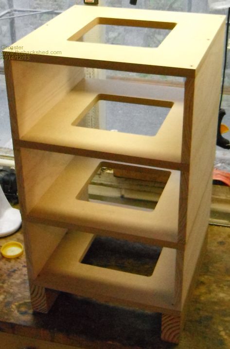

Posts: 10109
Posted: 09:59pm 12 Dec 2014
I forgot to post the photo ages ago:
This shows the first four floors out of eight in total, so this is the building under construction at 50% of it's final design height, but you can easily see the elevator "Shaft" and how the floors will look.
I changed the design a little and decided to put left and right walls in for structural reasons. I was just going to put little corner bits in, but it was easier and involved less cutting to just make "Walls".
The front and back will remain completely open, so you can see the cabin and counter-weight riding up and down on the guide-rails. I plan to put the remaining floors on it tomorrow so that I can then paint it to protect the wood. Once I have done that, I will set about installing the guide-rails, cabin, counter-weight, cables, sheave and motor.
Still plenty to do, but it should be a somewhat unique project among my others!
Posts: 2998
Posted: 04:30am 06 Dec 2015
