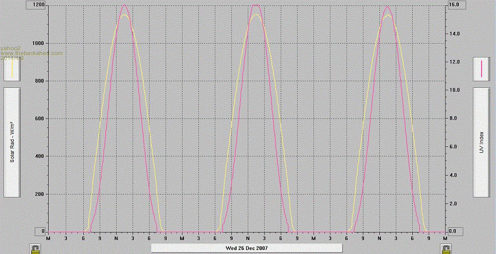

Uv is only good for frying bundy drinkers! visible spectrum is what we are after.
Infra Red and UV dont have enough kick to dislodge an electron.
Here is one I prepared earlier! Christmas 2007 temp was low 30's Celsius.
visible radiation on the left (yellow) UV on the right (appropriately pink)
