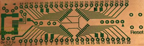

Hi Don,
Great to have your feedback!
  Quote  A single pin for +5V out? It would be good if you can squeeze a GND pin beside it, rather than the user chase the appropriate GND pin on the 44 pin DIP device, or elsewhere on the board.
Regarding the single 5v (out) pin, I originally had 2 rows of 23 pins with this 5v pin on the top left (pin 46) along with a ground pin on the bottom left (pin 1). However this made identifying the correct PIC pins a little confusing (e.g. DIP pin 1 = 0v, DIP pin 2 = PIC pin 1 . . . .DIP pin 45 = PIC pin 44) and hence felt it better to directly simulate a 44 pin DIL package with each DIP pin matching the PIC pin number. (Have I lost you yet?). However, I thought the 5v input from the USB socket should be made available to the user so included it on the module as shown.
All this said, I do think it is worth adding a ground here to make it a two pin header. Perhaps even a three pin header and include 3v3? What do you think? - like you say this avoids having to 'chase' the correct pins for power.
  Quote  I assume it could be used for 5V in, or 5V out?
It wasn't intended as a power input but yes it could be. However I wouldn't currently recommend this as I haven't included any protection in case something is also plugged into the USB at the same time.
  Quote  A 5 pin PIC ICSP header?
Do you mean why not 6 pins? If so then the reason is I have never had a requirement to use Pin 6 so hence didn't include it. Is there a reason you think I should include pin 6? OR are you asking why its there? If so, then obviously it is to update firmware whenever Geoff sends out updates.

Lads,

  WhiteWizzard said   Hi Don,
Phil
Thanks Phil,
To save you quoting me, quoting you, I'll start with a clean slate.
If you can make it a 3 pin header for power, yes that is even better.
However you may have to move the LEDs together, or something similar to make room for the header.
I'll assume there will be a small assembly text file, and schematic to go with the files, so I would make it voltages out only, and mention it could be used as voltages in, if the USB input isn't used. Mind you, I would expect that the user would be familiar enough with the board and schematic to be able to configure what he wants/needs for development, or the final application.
Re the 6 pin header, sorry I should have enlarged the question enough to make it fully understandable.
PICkit 2, and 3 is a 6 pin header, (as are the clones) so I felt there would be less confusion if you placed a 6 pin header there, even if the 6th pin isn't used.
Which bring me to my final point:
Text. Will you have a text overlay?
It needs a "1" near pin 1 of the 44 pin DIP socket, and "1" near pin 1 of the ICSP socket.
When it is being manufactured by a factory, or an individual, it is only built once, so other text such as LED polarity will generally be obsolete after being manufactured.
If you find room for text, then place as much as you can on either side of the board.
Even if it just says "+", "G", "5", "3". It will all help.
Cheers Don...

Don,
Great suggestions so will work on them straight away.
Note: I will probably leave 5 pins for the ICSP due to space limitations; but will clearly indicate ICSP Pin 1
Will update when complete . . .

Posted: 11:09am 09 Feb 2014
Hi all,
Based on Don's feedback I have slightly modified the top PCB.
This is a pre-etch photo to show the following:
* Pin numbers (equate to PIC pin numbers)
* Group of three power output pins labeled 0v, 3.3, 5v (lower left corner)
* Pin 1 identity on ICSP
* Date flow direction 'arrows' next to coms LEDs (Rather than say Tx & Rx which can get confusing depending upon from PC of from MicroMite's perspective)
The numbers are about the same size as the small numbers found on a breadboard. I don't want them too big - just big enough so you can go straight to 'pin x' without having to (mis)count pins.
I will etch this in the morning as it's too late now.
In the meantime please let me know about any more suggestions you may have!

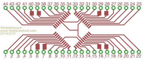

Posts: 2998
Posted: 02:45pm 09 Feb 2014
Hi All,
In a rush to get something available to you all, please find below the file required to allow you to create your own PCB for the 44pin MicroMite.
2014-02-10_004139_MicroMiteDIPv2.brd.zip
It will create a 44 pin DIP allowing you to use it in a breadboard in a similar way you would use a 28pin PIC (but obviously with all the extra I/O pins).
To clarify, this isn't the file to create the more advanced Eval PCB/Module which I am now finalising the design.
So for those of you who don't currently have the ability to test Geoff's software for the 44pin MicroMite; i.e. if you don't currently have any TQFP adaptor board, or you are still awaiting delivery, then why not have a go at building this simple PCB!
This is an EAGLE .brd file from which you can print out the artwork for the single sided PCB. If you don't have EAGLE you can download a light version for free from the following link:
Free EAGLE download
Hoping this will prove useful to some of you.
Phil
