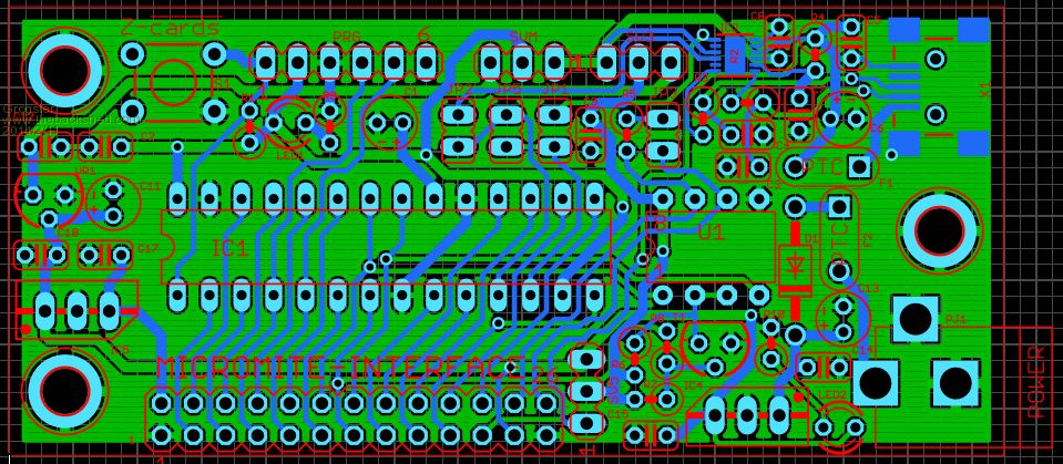

  Zonker said   Good evening Gents..
Ok, First round of updates Done...
Let me know what everyone is thinking on this...
Zonk
2014-02-06_043829_MicroMite_PCB.pdf
2014-02-06_043912_MicroMite_Scat.pdf
2014-02-06_043946_MicroMite_Silk.pdf
Please forgive me if I am misinterpreting your PDFs Zonk, but no mounting holes?
Don...

@ paceman - yes, the 1262 would be a good choice here. I always like the MCP1703 series regulators, which are also LDO. I would have to have a quick gawk at the PDF for the 1703's to find out about their voltage accuracy - the 1262's could be better in that respect...
@ Don - Correct. The PCB is designed to be self-supporting, when you plug it in via it's I/O edge-connector or IDC type connector. It is small and light enough for that, but mounting holes would have been a bonus - not sure if there is any way that can be squeezed in now though! Edited by Grogster 2014-02-08

  Zonker said   @ Don.. Thanks D for chiming in on this thread..! I was not thinking correctly about the need for mounting holes .......................Would putting 4 mounting holes in the corners be ok..? It would make the board bigger,
Gday Zonker,
Join the club... I have designed many PCBs for Don in the past and almost always he comes back with "where are the flaming mounting holes.. Sonny??" SO that brought a smile to my face..
I assume that you use an auto router so you should be able to squeeze the holes (3mm) into the corners and move a few components to clear them.. Personally I like a smaller PCB rather than a larger one (esp if its just for mounting holes).
Whilst it is tight there is still some room to squeeze tighter (gap between resistors can be tightened to 0.1" - They look like 0.15" and they can be 0.3" axial instead of 0.4" axial... And for that matter they can actually be vertical mounted so only take up a 0.1" foot print, 1/8W resistors can even be called for and they only need 0.2" axial footprint.
Also what is your idea with the PCB edge connector below the 26Way header? Do you really need that? If you move the 26way header down a bit and remove the edge connector then there is some room to shift some components between the 26way and the Pic32... If your idea is to use the edge for (vertical) mounting then install a R/A 26way header for that purpose.
Great work on this design it looks fantastic and I want a few.
EDIT** Also if you think its still too tight you could delete the PTC resettable fuse.
My 2c worth, please dont take it as anything but CONSTRUCTIVE criticism.

Yep... I guess your right here Mik... I didn't think about the possible use as a small platform board too... I will scrap the layout and have and have a go again with the holes this time.. I like your idea of using smaller parts.. Was trying to keep it easy to build using the through hole parts... BTW, it was all hand routed,... (I hate most auto routers) They can never seem to get small boards finished... Looks like this will take a few more days...

  Zonker said   BTW, it was all hand routed,... (I hate most auto routers) They can never seem to get small boards finished...

Posts: 2984
Posted: 07:44pm 09 Feb 2014
  Zonker said
Anyway, See if this one is OK with everyone...
Plus, getting an expansion board going...
Gday Zonker,
Looks fantastic... I like the way you have made the bottom layer mostly GND plane.
One small thing, that does not need to be changed, The pushbutton for RESET.. I usually use diagonal pins so that if someone puts the switch in at 90deg it will still function as expected as no matter how you put the switch in it will work OK.
Also I would prefer Pin 1 of the ICSP header marked instead on Pin 6.

Hi Zonker,
Been watching your progress with keen interest - and WOW, its now looking very good indeed.
Just two things:
1> IMHO it is worth changing the connection point of the reset switch as currently if it is pressed when a PicKit is connected (and programming) I believe it will create a short between Vpp & Gnd.
2> What PTCs are you using?
Once again, a real nice board you have created here.

Attached is the Gerber files for the 28 pin uMite board. I got a price from sunstone circuits of $14 a board if I order 25 of them. I am not sure how many I should order, but that gives us a basic price for now...
If anyone wants to check the files with a gerber viewer program for verification besides me would be helpful. I should be able to check them later after work.

After a bit of playing around, I got it imported into Sprint Layout 6 OK.
The filenames and extensions are a bit cryptic!

Sprint Layout 6 sees your board files as:
Sprint Layout uses different colours to that of Eagle etc, so this is why it is a different colour.
Sprint Layout 6 thinks that the top copper layer is blue, and the bottom copper layer is green. Top silkscreen is red, and no bottom silkscreen.
