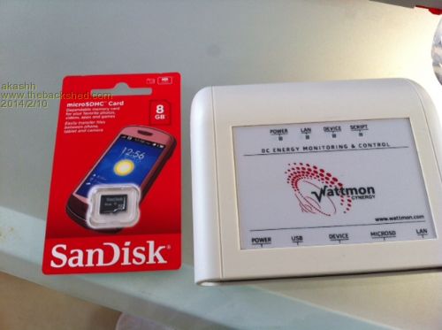

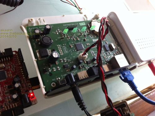

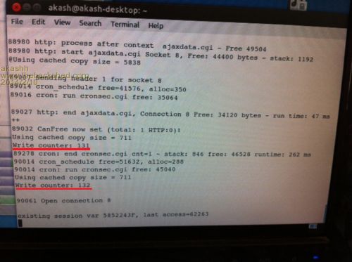

Alright, I have set up a script to open a file, read a counter value, increment and write it back once a second. I have included a couple of pictures of the setup, and the code I am using. This should give us results pretty rapidly, within a couple of days I would guess since this modified the fat and the file 86400 times a day.
This is the Wattmon device I am using and the SanDisk 8GB brand new SD Card
This is the setup (I had to open the cover to get to the serial console)
Here is a view of the console with the output of the script underlined in red, counting once a second.
