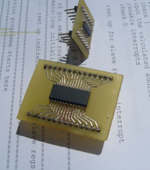

@ TZAdvantage,
I have got one each of the data expander and PIC1503 you sent fitted to an adapter board so that I can plug into a bread board for testing. Photos show I was a bit heavy on the tin paste but at least there won't be any cracks in the tracks.
I'll start with the data expander first run off the MM I2C bus and then work on the translation of the F88 to F1503. It is going to be 40C+ for the next couple of days and too hot now to work outside although the back shed is double leaf masonry and a lot cooler than outside.
Anyway, it will be a chance to sit back and relax a bit and see if I can get the grey neurons working.
Thanks again Downwind for the SMD vise tool.Edited by MOBI 2014-01-15

Posted: 04:30pm 13 Jan 2014
Handy little adapter boards, they look good, and a bit extra tin doesn't hurt.

Posted: 02:31pm 14 Jan 2014
Drat!
I made the data expander adapter board one row of holes too wide so it will plug into the bread board but I can't access one row of pins. Never mind, I have plenty of MM, MF and FF jumper leads. It just makes the set up a bit messier. I should be used to that by now

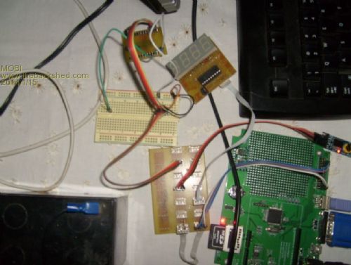

MOBI
Joined: 02/12/2012
Posts: 819
Posted: 05:54pm 14 Jan 2014
  paceman said  What about if you just plug one row into the outer hole row and the other into another breadboard? That's easy and keeps the proto-ing reasonably neat.
Yes, that is an option, but it is just as easy to turn the board upside down and plug the leads on the "top"
The ankle bone's connected to the leg bone.....the....
The MM i2c is connected to a two row i2c bus which is connected to peripherals. The bus is connected to the bread board which is connected to the expander adapter board. It is all a bit fuzzy (focus and explanation), but it is working. The LED display was for getting the bus working and connected right as I knew it worked.
There seems to be a million and one instructions for this 16 bit expander. I'll work on getting a basic "blink a led" first.
