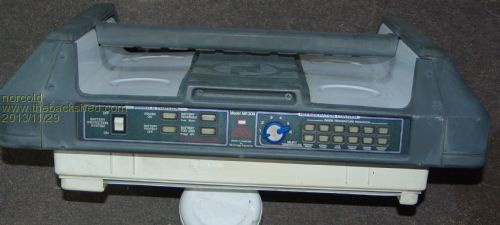

Fridge Mate (my take on this) was a OZ Co in Qld, they built an innovative fridge/freezer around the mid 90`a (from memory). The idea seemed a brilliant one it had the complete compressor, condenser and evaporator built into the removable lid. It failed (again my take) because the compressor had no life. The idea had a lot of merit. The unit wasn`t available for long because of the compressors shortcomings.
Have one a customer had asked me to repair, I advised against repairing (costs) and the customer left it with me. He took his lose and didn`t chase good money after bad results.
Have a feeling that a manufacturer will take up on this idea.
