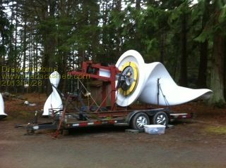

the very thing that makes your mill so attractive is what is reducing it's power output.
the wide base wants to rotate at a different linear velocity than the narrow top.
one end is dragging the other end around.
the other end is acting like a brake.

Thanks for the comment electrondady1.
I disagree that they bottom is dragging the top, though it's a reasonable idea and I can understand how you'd get there. The reality is in the numbers, which you can see in the report if you wish (link posted above).
What's actually happening is that some flow into the turbine is moving upward, increasing the velocity of the flow that's above it, and effectively locally producing a higher velocity, and therefor maintaining a fairly consistent TSR.

I'd love for community members to check my thinking on Alt design which goes as follows-
Given that their is a lower operating rpm due to lower TSR (1.2 to 1.5 for ART)
Then a suitable alt for a low RPM turbine will need more magnetic poles in a larger dia circle, as
the larger the circle of the magnet array,
the more poles, and
the more magnetic flux you can get,
the faster the poles will move over the coils ( 12" dia circle will have roughly a 37.2" dia ring, so would be 40" per rev speed, whereas a 24" dia ring would have a 76.4" ring, so 76.4" per rev.
So, the larger ring alt gets the benefit of both 2x the speed, and 2x as many magnets (more flux)?
If the coils are the same size, but 2x as many coils, the total output should be 4x, in 12" vs 24"?
An issue with how the coils are connected could be that if you connect all the coils in series, you increase the resistance?

The configuration right now is 2 1.35 meter dia annular metal plates (held apart by 12 x 1/2 jacking bolts, I do have up to 2m dia available, but it's much easier to work with what I have.
What I did was buy 144, 1" x 1"x 4" ceramic magnets, and glued them to the plates, so each plate has 72 poles. I hoped that that volume and number of ceramic magnets would be enough to generate the output I am looking for. What I found was with a test coil, that I'm only generating 1w where I need to be generating 10 w to sufficiently load the turbine. So what I'm thinking is I switch to rare earth magnets, using 3 of 1"x1"x1/2" thick magnets (to make a strip 3" long).
The ceramic magnets have a latching force of about 16lbs. The Ceramics have 64lbs each or 180lbs per strip. This should give me 10X the flux, in 3/4 of the space? Also because the strip isn't quite as long, I shouldn't have to have them quite as close together on the inside circumference, and so might have more focused flux?
I also have gone away from using an interleaved coil design, just using standard coils now (set of 54 to go with the 72 poles). If I needed to get a bit more juice, in theory I've could go back to interleaving coils, and increase the amount of copper in the stator by 1/3 (should increase watts out by 1/3?)
Does that sound reasonable?
I am a bit worried about the pulling force between the plates. 12x 1/2 bolts is pretty strong, however if the magnet plates were ever to come together, I'd have somewhere around 23,040lbs of force holding the plates together.

I'm taking the turbine into Victoria (B.C. Canada) to show at a conference on sustainability. Thought you guys might get a kick out of seeing it ready to ship. I'm sure it'll gets some interested looks on the highway! You also can see the Alt, yellow ring is the lower magnet array, gray inner ring is the mounting plate for the coils.
Soon I'll be removing it all, to install a proper lower bearing. Was a botch up in the way it's put together, right now the bearing arrangement is a bit ugly. When I have it apart I'll be changing the magnets from the 1x1x4 ceramic to 1/2x 1/2x 3" rare earth. This will also allow the winding to be a bit shorter.

I must say, That is a great looking piece of art.

How much power do you expect to make from that machine?
Just looking at the size of it, the area facing the wind isn't that big. Since we can work out how much energy can be extracted from a cross section of the wind, its pretty easy to work out how much power a windmill, be it vertical or horizontal, can be expected to make.
If you know the height and width of your turbine, work out its area, probably using area of a triangle maths.
I'm guessing 2 to 3 square meters facing the wind.
