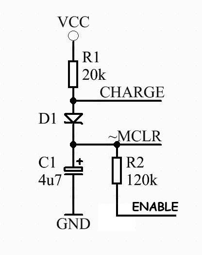

Lads,
Of course to deselect the cct for programming it is as easy as a shorting link between MCLR and the circuit...
Another thing to enable it to have no effect during reset/power-up would be to replace the GND on the RESISTOR with another output so there wont be a LOW applied to the MCLR when the micro is restarting.
As per this circuit, of course this requires an extra output pin but the watchdog can be enabled or disabled at will.
EDIT** I would think about putting the other diode back in as well, as a fully discharged capacitor could pull the MCLR low without it.

We would be best to go back to kiid's original circuit without the 20K resistor and including the second diode plus with Mick's ENABLE. It would seem we have an external watchdog with a startup and continuance under program control. So simple it probably could be soldered onto the board with a few common components.
edit:
I see a problem during development. If you stop your program by Ctrl + C or other means without resetting your ENABLE pin first then the watchdog is going to reset your processor and any program in memory will be lost. That could be a nuisance.Edited by BobD 2013-06-11
kiiid
Joined: 11/05/2013
Posts: 671
Posted: 09:31pm 09 Jun 2013
Nice corrections
Actually, instead of enabling the bleeding resistor, the ENABLE could be connected to the capacitor's negative lead instead. It will avoid any programming issues that way (it will be ~ENABLE, though).
I would leave R2 to ground and restore D2 and R1 in place.
Edited by kiiid 2013-06-11

Guys - some great comments coming in here - keep it up.
@ BobD - Yes, the CTRL-C break could be an issue indeed!!!
However, I guess that in those cases, you would need to make sure you disconnected ENABLE during those development conditions...

Looking further at the circuit first proposed by kiid and then with mods by Mick, something that will have a detrimental influence on that design is that the Maximite has an external 10k pullup to 3.3V on MCLR. That pullup will prevent the circuit from asserting a reset.
Posts: 2984
Posted: 11:41am 10 Jun 2013
  BobD said   something that will have a detrimental influence on that design is that the Maximite has an external 10k pullup to 3.3V on MCLR. That pullup will prevent the circuit from asserting a reset.
Hi Bob,
Yes you are right...
We could add a transistor switch to the MCLR line but it is starting to be more complex where a supervisor IC is likely to be simpler and more effective...
Also the Pullup on CHARGE will be no good either as if the PIC loses control the pullup would charge C1 and it would not do the job of being a missing pulse detector (assuming the PIC locked with the CHARGE output in a floating or `unknown' state)..
PS. THis has been an interesting topic (for me anyway)

It's a bit sad about that circuit as it was so simple but we (me included) never really looked into it fully and the simplicity was it's failing. I too am of the opinion that a supervisor IC would be the best solution. That was a very good article that TZA referred us to in a previous post.
