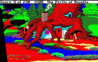

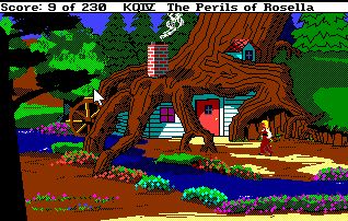

Posted: 03:25pm 20 Feb 2013
I agree. As it is, it's fine.
... but that extra 8 colours will make games look better!
Here is a 16 colour (RGBI) image taken from the graphics adventure game off the PC called "Kings Quest"...
And here is the same image in Maximite 8 Colours...
The question is, is 16 colours really worth the effort?
Nick
Posts: 10105
Posted: 05:21pm 20 Feb 2013
I said way back on the first few posts that I figured this was out of the capabilities of the CMM, and that I was perfectly happy with it the way it is, so hopefully you did not read too much into my last post.
I have said it once, and I will say it again - I am perfectly happy with 8 colours.
