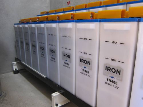

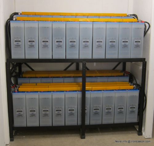

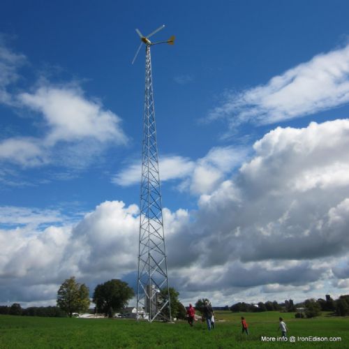

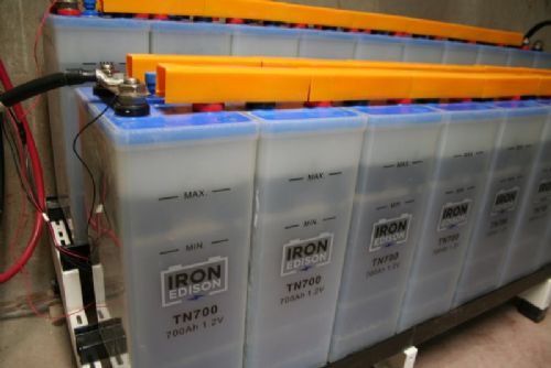

Here are some more project photos:
700 Ah 24 Volt battery near Moab, UT
400 Ah 24 Volt battery in New Mexico
800 Ah 48 Volt battery near Cadillac, MI
Wind turbine to power up the 800Ah battery bank

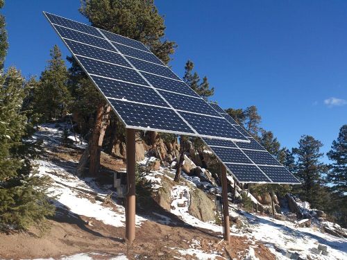

Solar Array to charge up a new 1000 Ah 48 Volt bank in Colorado

Wow!
Thank you ChargedUp, that is an absolute goldmine of information.

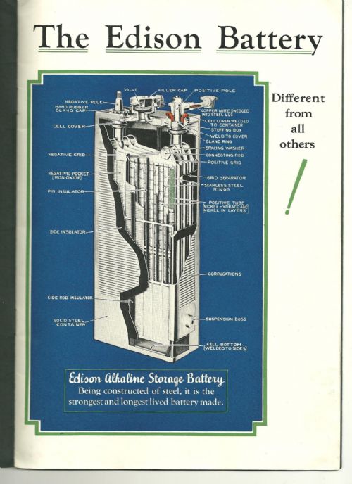

Thanks for the positive feedback. I love this stuff!!! Here are some more historical documents you may enjoy.
This 1914 Manual was purchased from Ebay, is a one-of-a-kind, and is the most expensive book that I own... just don't tell my wife how much it cost!
2012-12-28_204353_Edison_Manual_--_Battery_Charging_1914.pdf
