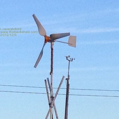

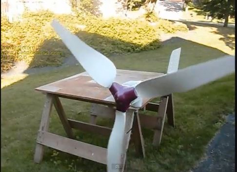

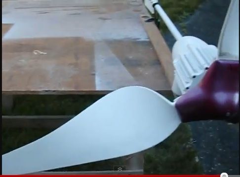

Posted: 07:50am 05 Dec 2012
SPOT THE DIFFERENCE
Example 1
Example 2
Example 3
Mine
Some Energy is Some Energy
Posted: 09:19am 05 Dec 2012
Well it looks like you need to take that turbine down after all.
Yep, blades on backwards, and yep, that would kill the output power. And we've all done silly things in the past, join the club.

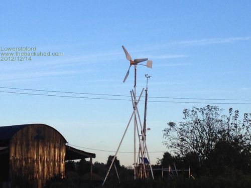

Im sure the blades are a little out of balance, but the main cause of the wobble is due the the tower construction
I will post some images but it is basically a wigwam, made from 4 scaffold poles.
Three legs and one center pole to which the turbine is bolted to.
I have now learn that scaffold poles are flexible.
The pressure of the wind on the blades cause the top of the tower to bend slightly, as the blades move round the pressure changes and causes the top to move bend back.
While this bend at the top takes place, the centre pole bends in the opposite direction around the middle point.
This creates a nice wobble.
I have now spent a good few hours in -3C to add bracing to the tower. I am no where near finished but so far I have greatly reduced this effect.

Turbine and tower MK1
Pre correcting the blades and adding bracing
