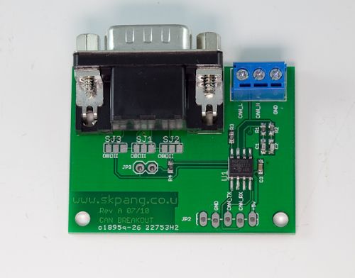

and then there is this (there may be others -- I just stumbled on this by accident):
http://shieldlist.org/skpang/canbus

If you need a simple board to test this out, here is one I've found:
I've also seen mention of the Arduino CAN shield that uses the MCP2515 -MCP2551.
CAN shield
