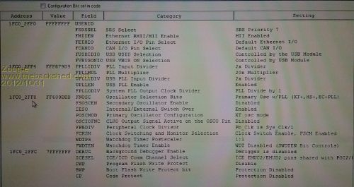

Zougie
Joined: 04/10/2012
Posts: 18
Posted: 02:56pm 30 Oct 2012
Finally success!!!!! Spent a couple of hours last night trying various things to breath life into the UBW32 MCC including a benchtop power supply and V4.0 software with bootloader. Initially, I had little success. The PIC programmed successfully but was not responsive once reset. Current draw from the power supply was tyically 20ma....not much at all. I then loaded the native UBW32 bootloader and it loaded and instantly came to life. Current draw jumped to 120ma and USB activity was detected at the PC end. I decided to dig deeper and look at the configuration bits. The Maximite configuration I had was somewhat different to the UBW configuration. I became even more curious when I was just how different the clock/oscillator configuration bits were. If these are not configured correctly, the PIC will have nowhere to go. I made the changes to the Maximite V4.0 file configuration bits and tried reprogramming the PIC. This time it came to life and drew the correct 120ma. Also, all of the A/D pins were accessable and the unit has performed as expected.
Attched are the settings I used:
So it looks like MPLAB configuration bits got me....and am curious how no one else has seen this before.....or have they?
Thanks again everyone for all of your support!!!
Cheers,
George

Posted: 03:07pm 30 Oct 2012
George, that photo is not the best. Why don't you have another go and attach it as a JPG file and it will be able to be displayed much better.

Zougie
Joined: 04/10/2012
Posts: 18
Posted: 02:32am 31 Oct 2012
Mick, I too find it odd that two separate PCs at work and a laptop at home with MPLAB 8.87 all programmed ok, but were setting the config bits differently to what is required for operation.
As for the dodgy screenshot I sent through (sorry Bob), I'll put together something more legible.
Is anyone else using MBLAB 8.87? I'm wondering if there is something going with this version?

Wajkaj
Joined: 03/11/2012
Posts: 14
Posted: 04:39am 04 Nov 2012
Had exactly the same problem as Zougie.
I use Pikit 3 and Mlab 8.50 and Mlab X and both do the same.
Thanks to Zougie, i changed the config-bits too and it works.
It seems like it is only the config-bits thats giving the problem.
The UBW32 works just fine now and i tested all I/O and several programs.
No problems so far.
Thanks Zougie.
